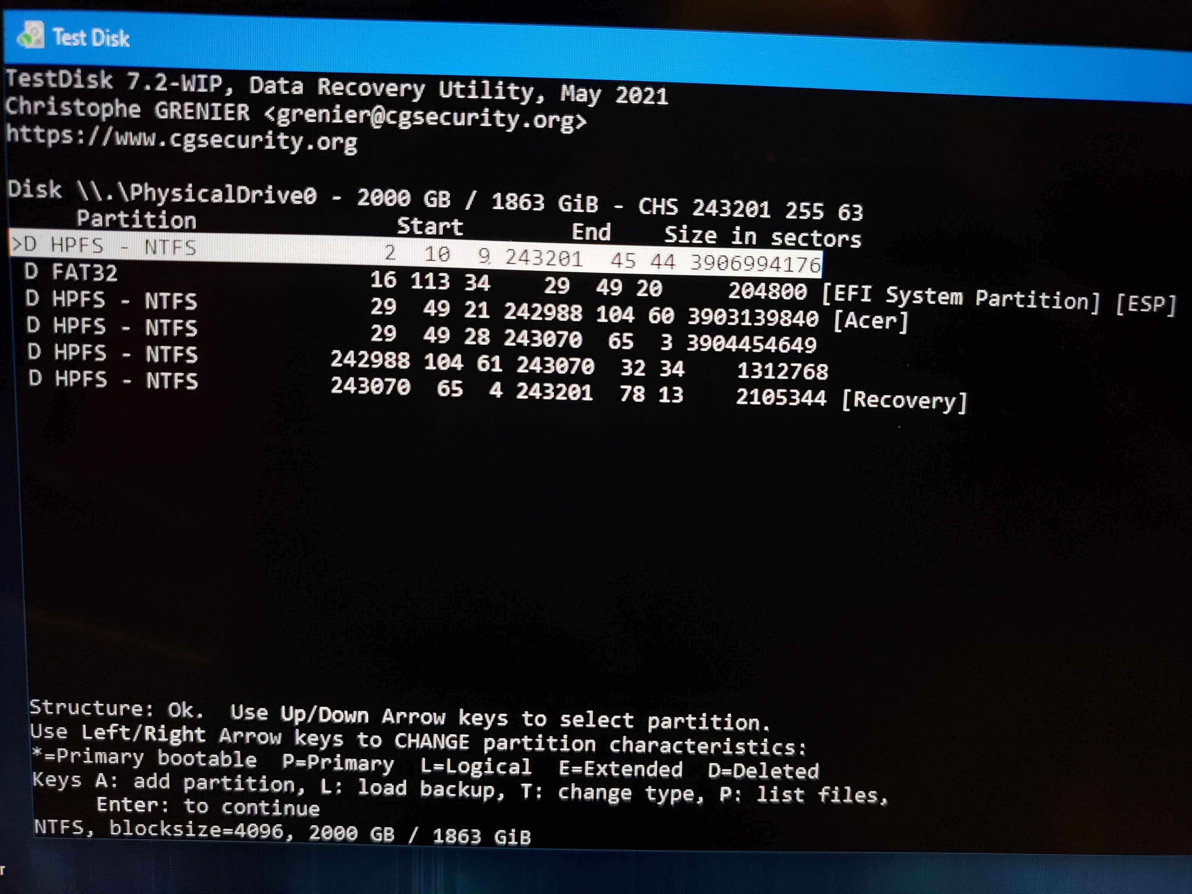

Hello, I'm looking for some clarity on how to recover a boot drive I accidentally ran 'diskpart clean' command on.
So I accidentally ran diskpart clean on the wrong drive, in a freak accident.
I haven't touched the drive, so I know everything is still on it, but I need some clarity on how to ensure I correctly recover the drive using Testdisk. I search online, but could not find guide to recovering a windows OS drive similar to my situation.
So far these are the steps I've taken:
1. Run testdisk
2. Select create log
3. Select Intel/pc
4. select analyze (upon analyze I get: "Partition sector doesn't have the endmark 0xAA55")
5. I continue to "quick search" (it finds one *primary bootable partition) https://drive.google.com/file/d/1AThuQ5 ... share_link
6. I continue, and then choose deeper scan, and (now 6 partitions are available) https://drive.google.com/file/d/1AYPmDE ... share_link
The partition "Acer", was the name of the C: drive before the drive was deleted.
7. After checking files for each partition only one partition has my files which is the "Acer" partition
So which is correct partition to write, to restore the drive back to its working bootable state with data intact?

Re: HELP RECOVERING BOOT PARTITION (WINDOWS 10)
The existence of an "EFI System Partition" in combination with Windows 10 suggests that your machine used a GPT partition table instead of the one you selected.
I don't know what your original setup of partitions was - you should know instead.
Only looking at your second pictures suggests that your machine contained at least three partitions. It would be a bad idea to write a partition table containing just one partition.
The following link provides you with information how to search for partitions:
You should rerun Testdisk and post the new logfile. The logfiles in GPT setups are easier to read and recognizing overlapping partitions will be much easier...

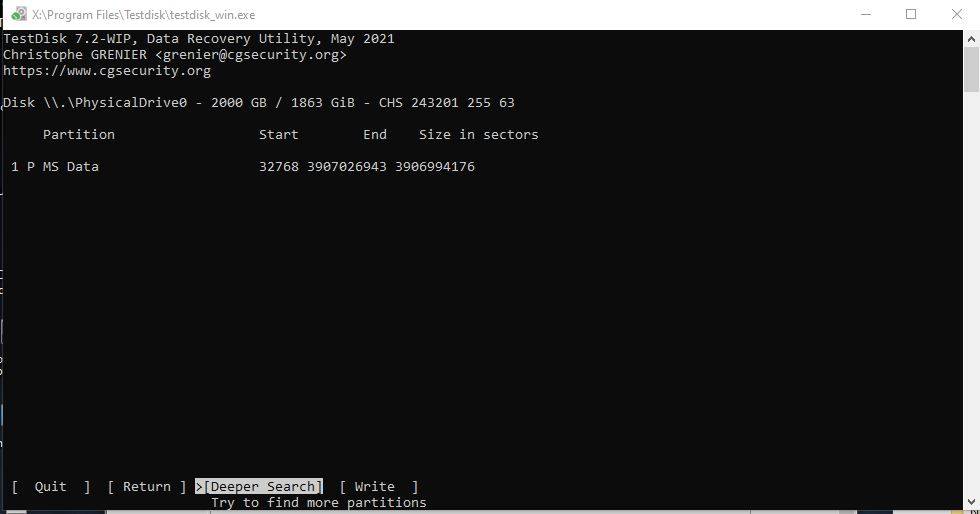

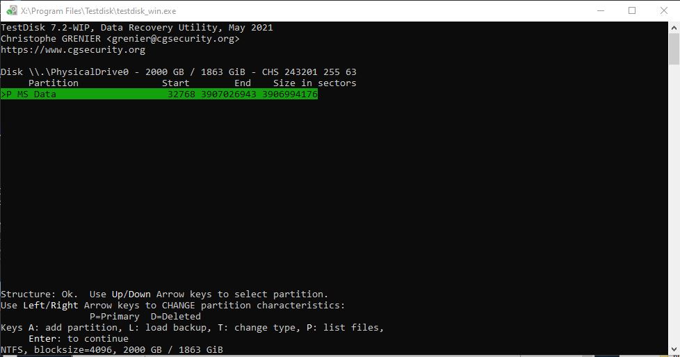

So I ran Testdisk again
1. Select GPT, scan, I get this prompt:
Trying alternate GPT
2. I choose quick search: it finds a partition named "MS data" 3. After continuing, and choosing deeper search, the scan starts, BUT after scanning for 4-5 hours it appeared to only be 0.4% complete (2TB drive). So I cancelled and was unable to generate a new log file.
Do I need to do the deepscan in GPT mode to properly recover the correct 3 partitions? Or were the 3 correct partitions available with the intel/pc scan results?
The original structure of the drive is as shown in the pic below. I have cloned this drive several times, so this is a picture of a smaller 250gb drive with the same partitions. Disk 1 is the smaller clone, and the 'unallocated disk' I accidentally ran 'diskpart clean' on.
There are 3 partitions that are supposed to be on this drive: EFI, ACER, and then Recovery:
