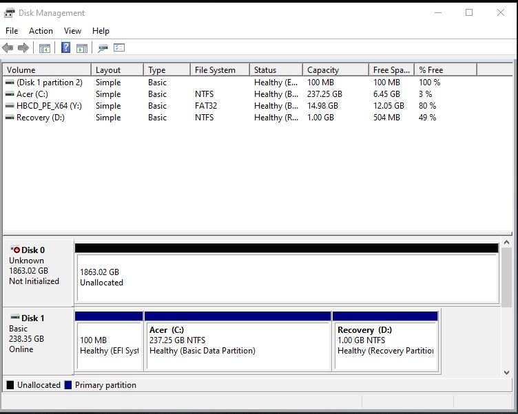

Yes, the drive was originally formatted NTFS, partitioned GPT. it was a regular Windows 10 OS drive.
The original structure of the drive is as shown in the pic below. I have cloned this drive several times, so this is a picture of a smaller 250gb drive with the same partitions. Disk 1 is the smaller clone, and the 'unallocated disk' I accidentally ran 'diskpart clean' on.
There are 3 partitions that are supposed to be on this drive: EFI, ACER, and then Recovery:
disk partition.JPG (65.7 KiB) Viewed 22501 times

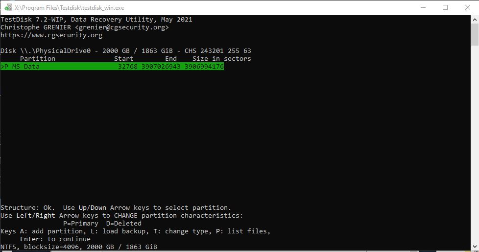

So I ran Testdisk again
1. Select GPT, scan, I get this prompt:
Trying alternate GPT
2. I choose quick search: it finds a partition named "MS data"
3. After continuing, and choosing deeper search, the scan starts, BUT after scanning for 4-5 hours it appeared to only be 0.4% complete (2TB drive). So I cancelled and was unable to generate a new log file.
Do I need to do the deepscan in GPT mode to properly recover the correct 3 partitions? Or were the 3 correct partitions available with the intel/pc scan results?

So I ran Disktest again

The 250 gb drive shows the exact partition structure that was on 2 TB drive, with the exception that the 2 TB drive's data/OS partition (Acer) is larger.
In short the 250 gb drive is a reference to the partitions that I am looking to recover on the 2TB drive. You were correct the 2 TB drive had the 3 partitions: EFI, Acer, and recovery.
