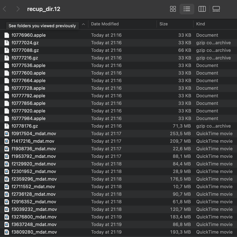

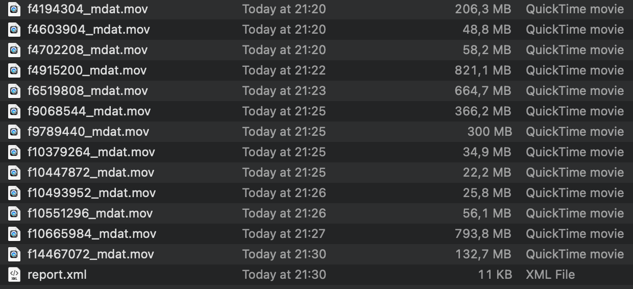

Here's a screen capture of everything I recovered:
I did activate "mov/mdat Recover mdat atom as a separate file" in the settings.
Does anybody know what I'm doing wrong and why I'm not seeing any ftyp files?

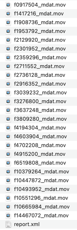

Re: Ran PhotoRec, many files retrieved, but no ftyp files?
I tried with these settings and got this result (the same than the previous one I think):
