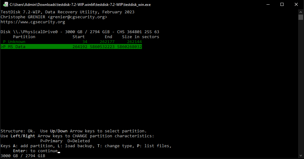

This is what I meant by "testdisk is still running". The quick search was finished. I did not quit this, because I don't know if I close this window I have to do the 40+ hours quick search again, or not:
Right now I am at this stage
Screenshot 2023-07-27 195224.png (28.15 KiB) Viewed 24147 times

#4 Post by recuperation »
Drum8579 wrote: 27 Jul 2023, 19:03
No, you failed to look to the left hand side at the bottom of the page.
I did, and there was only "options". Now, I can see both "Options" and "Attachments", so I attached the logs. I also see that now I am not inside the new users group in this forum.
Thank you for letting me know! You are right, I can confirm that behaviour using a new login.
It is labeled Photorec.ses and should be located in the folder containing both Testdisk and Photorec executables.
I could only find a Photorec.se2. The forum says it is not supported, so I created a zip file, and uploaded that.
That should be it, sorry!
Do name the broken drive. I can't foresee which one(s) of your possible three disks is broken.
It is the PhysicalDrive0, the Western Digital.
Do not cut that reports into pieces or stick something together like you have probably done the Testdisk log file.
I did not cut any report, and did not stick something together. Why would I do that? I don't understand that much of the log to alter it. And if I alter the log, noone can help me. I simply opened the file, hit ctrl-a, ctrl-c, and ctrl-v here. Can we just assume I did not alter it, because that would be absolutely against my interest? How can I prove that the log is authentic? Everything is connected as is.
Testdisk lists all disks when being started. In your case they were ranging from 0 to 3. Suddenly another physical drive (number 4) appears not being listed at the beginning of the log. There is no explanation for that.
Smartmontools report as I am only allowed to attach 3 files:
Your smartmontools report does not exhibit any nasty surprise. The time that Testdisk needed appears high, if it was searching in a linear manner 3 TB in 40 hours yield 20 MB / sec which is low. How did you connect it?
Anyway, the next step is to use the "p"-key ("list files") to see if Testdisk can decode the content of that partition.

#5 Post by Drum8579 »
Now I understand why you thought that I altered the log, I have to say that. I wish I can give you an explanation. I am just embarrassed (I am not sure this is the right word for this, probably not), because I have no way to prove, and I understand that every evidence is against me.
This is a desktop PC, and an internal drive, it is inside the case, directly connected to the motherboard, via SATA. As far as I know SATA3, this is about a 3 years old computer.
It says "can't open filesystem. Filesystem seems damaged."
