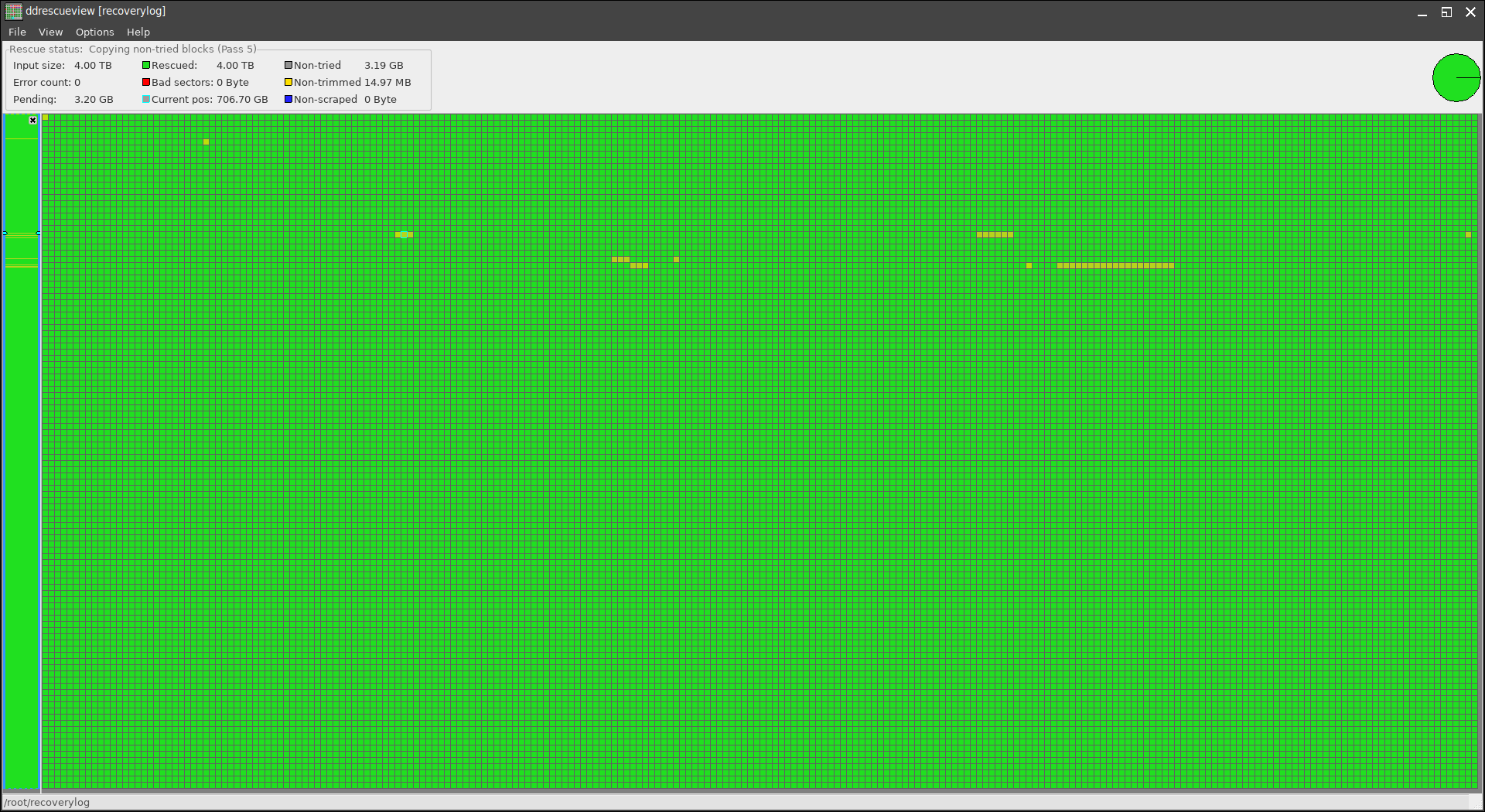

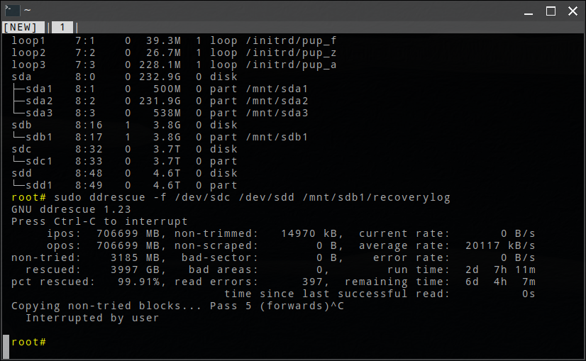

  • Based on the previous advice, I have used ddrescue, which could copy most sectors from the device to another 5TB drive (did not have another 4TB so could only make it work like this). As per this there are no bad sectors either, just around 3GBs that cannot be read. Please see the screenshot of both the resulting command line and the recovery map attached.

Using ddrescue was the right thing to do.
When duplicating the disk onto a bigger disc using ddrescue, it is a good idea to complete delete the clone target before filling it with zeros. This will prevent confusing TestDisk and other recovery software to interpret invalid content in the last TB of your target disk.
As you definitively have a broken source disk you should duplicate your clone again to have a clean second clone of your broken source.
You can use the second clone to play around without worries.
If you do something wrong with the second clone you can clone the first clone to the second one again.
This will be pretty fast as you do not face delays due to unreadable sectors.

You have unreadable sectors. A smartmontools report would deliver more information. Using ddrescue was a good idea.
Keeping your ddrescue logfile enables to continue the recovery in the future.
In the mean time you should not modifiy your first clone.
I would rerun ddrescue so that it takes care of the unrecovered area if you are not in a hurry. Transfer speed will guide you a little bit. Due to the number of read retries by the firmware of your disk the transfer speed can drop dramatically.
