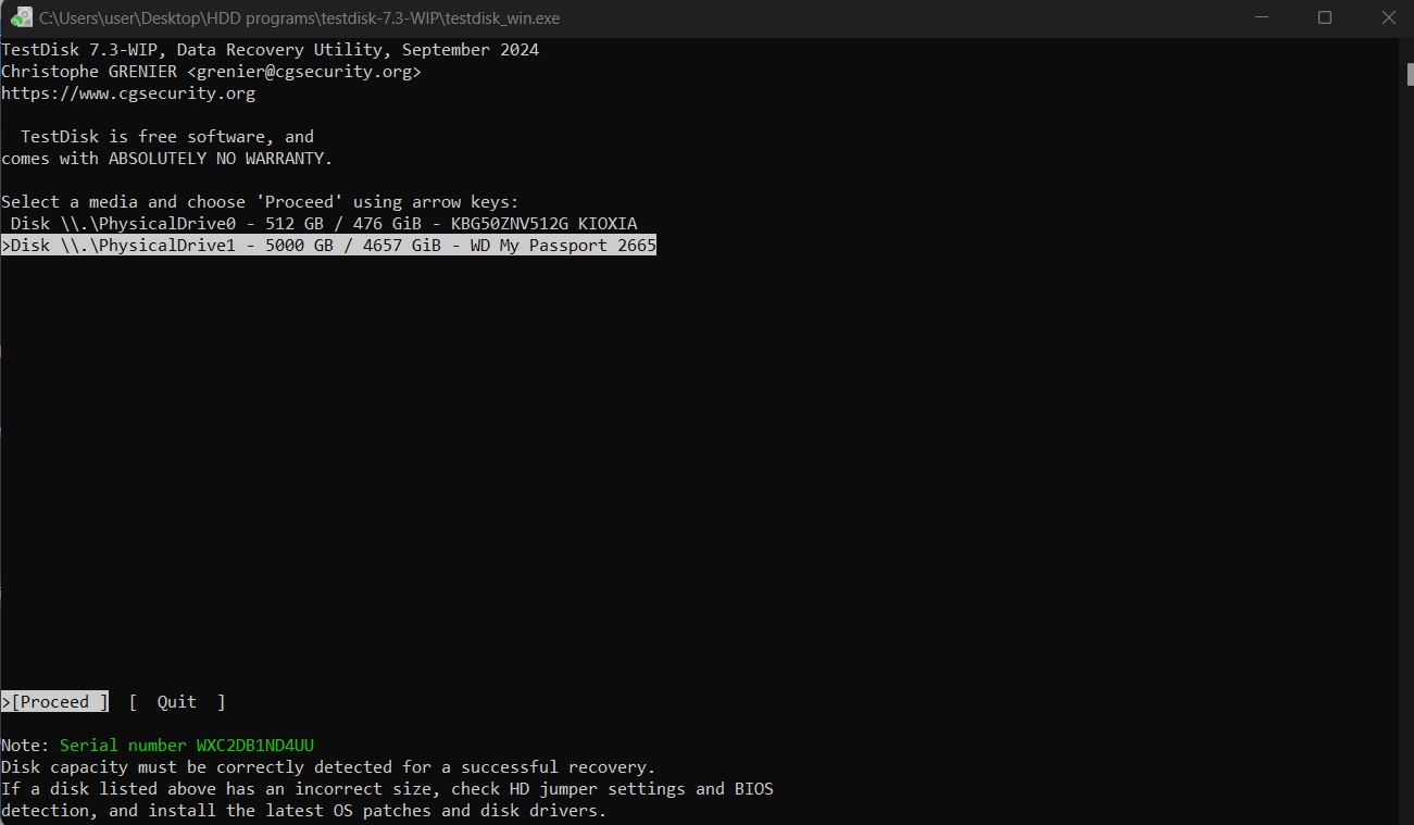

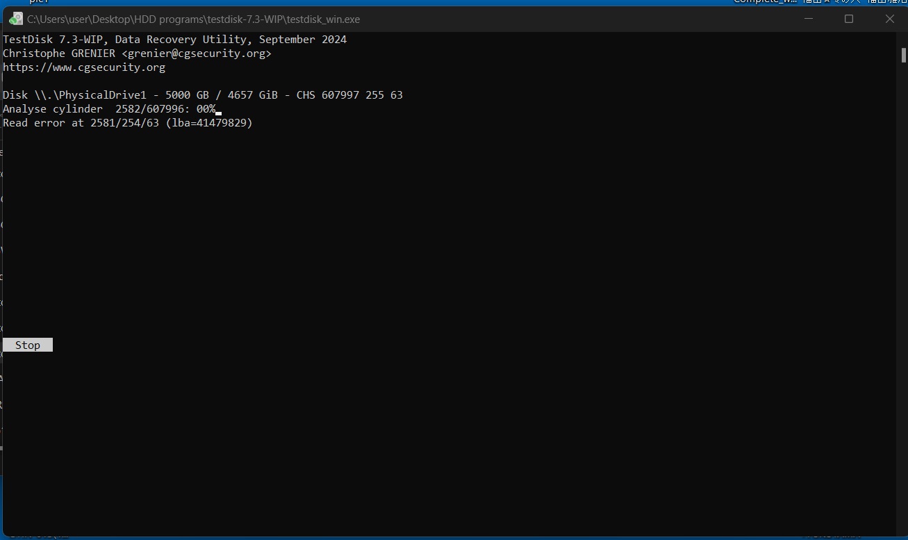

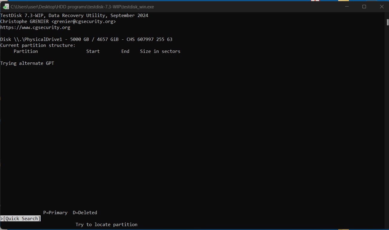

- Testdisk view
- pic7.jpg (112.71 KiB) Viewed 35532 times
- Analyze
- pic8.jpg (83 KiB) Viewed 35532 times
- Large log file starting with this
- pic9.jpg (78.54 KiB) Viewed 35532 times

I posted photo the first ever time I tried using Testdisk, which I stopped at 2% of reading as the log file was more than 100GB.
I want to try again with your recommendation to post part of the log, but seems the hard drive is not work anymore with Testdisk.
