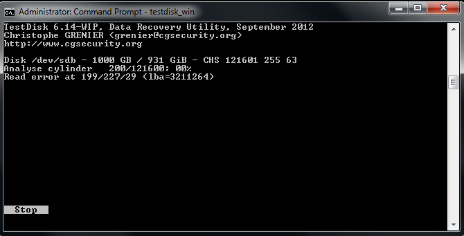

I got "partition reading error" and I used TestDisk to do an analyse and it had already took 24 hours and still running. I didn't run TestDisk 6.14 as an administrator. Can you advise the problem as I need to recover my data back?

Still running.
- testdisk_win.png (37.5 KiB) Viewed 12564 times

Same here, each sector takes ~1 second. A complete deep scan on a 2TB HD take 2.81 days.
Any advice??

How many read errors did you get?
Read errors can cause that datarecovery software hangs during a scan.
Can you test your disk, using crystal disk info?
