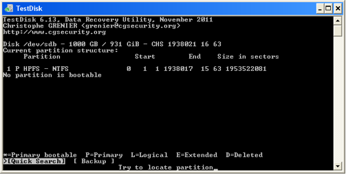

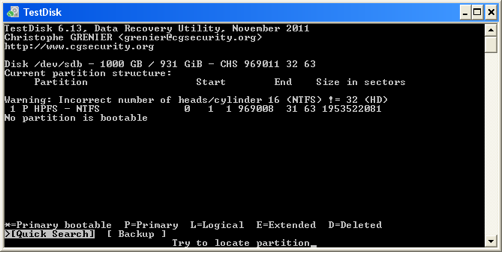

Hi Fiona,
here are the Testdisk screenshots:
16 heads
Quick Search(16).png (27.7 KiB) Viewed 19947 times

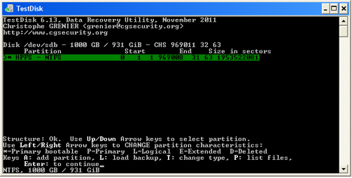

Re: Wrong Geometry
Posted: 23 Mar 2012, 10:55
by kaxyus
32 heads
32 heads
thanks for your help

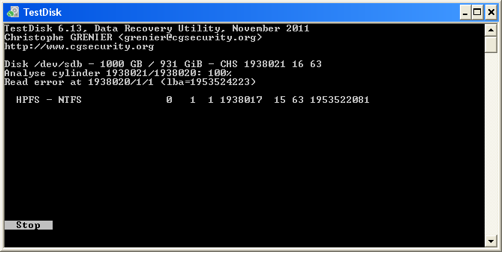

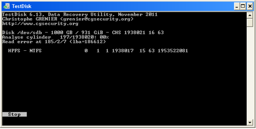

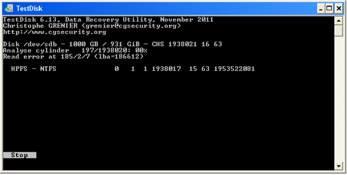

Re: Wrong Geometry
Posted: 23 Mar 2012, 20:09
If I ask the list of files TestDisk detects only two folders that contain a few gigabytes.
I assume that folders are lacking?
As far as I've seen, you've got a couple of read errors.
http://forum.cgsecurity.org/phpBB3/down ... php?id=189
http://forum.cgsecurity.org/phpBB3/down ... php?id=190
It could indicate a damaged file system.
You should stress your harddisk as little as possible.

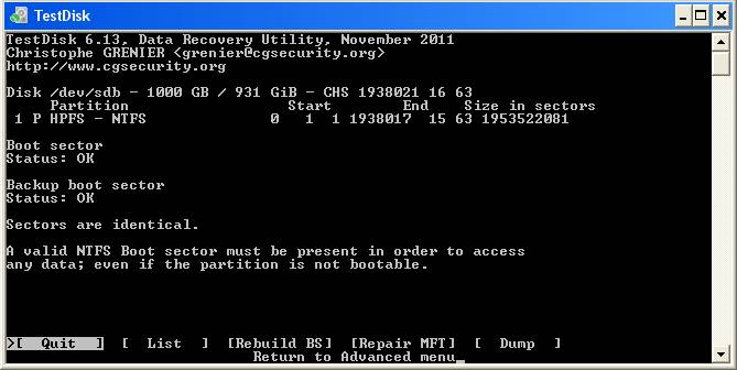

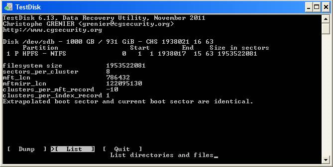

here the screenshots related to the Boot and Rebuild BS command.
Rebuild BS was very quick, few seconds. The List menu appeared, but the result has not changed: the root folder appears, but inside there are only two folders, not all of those originally present.
Re: Wrong Geometry
Posted: 25 Mar 2012, 11:48
There is no change.
Looks like your file system is damaged.
In your case datarecovery software mit be necessary.
You can use PhotRec or commercial software if you want to try it first (demo).
PhotoRec doesn't keep file names and directories.
