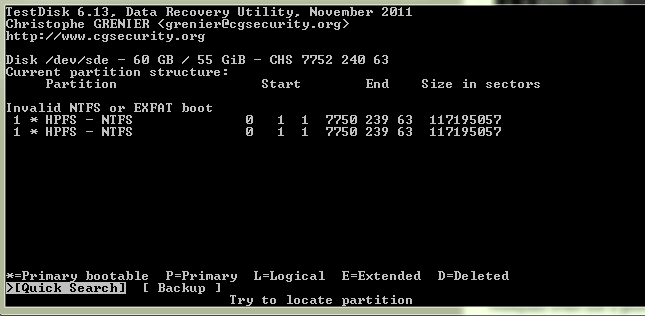

I went to Advanced and then Boot and this is the result. I also tried list but nothing happened.
- Screenshot 9.PNG (15.42 KiB) Viewed 16176 times
Re: Help please!
There is no valid boot sector available.
Did you test Recuild BS?
If not, please check it, and press enter.
It should take a couple of minutes.
If it takes too long, please let me know.
Only if Rebuild BS had no result!
Might be possible that Deeper Search would be needed too.
In case, confirm in Testdisk at Analyse, Quick Search and then Deeper Search.
Might be possible that Deeper Search will find another partition.
Please keep 240 heads in the menu geometry!
If Testdisk would find another partition, please check it und press p to list files.

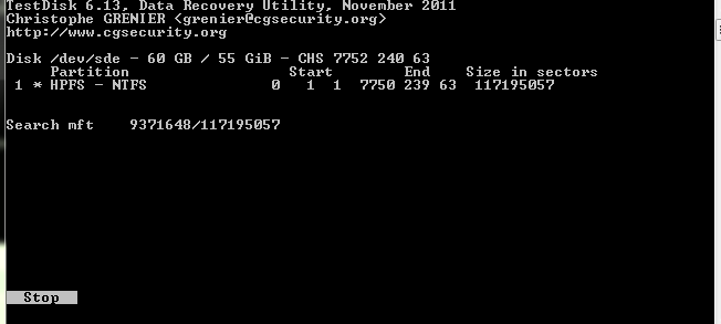

A Rebuild BS has been running for about 10 minutes now (see Screenshot) and has not finished?
- Screenshot 10.PNG (12.77 KiB) Viewed 16169 times

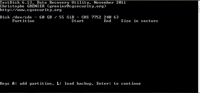

Re: Help please!
I stopped the Rebuild BS as it was taking a long time. I have now run a Deeper Search and this was the result
- Screenshot 11.PNG (12.84 KiB) Viewed 16165 times
Re: Help please!
Sorry, that last screenshot should have shown that no partition was found.
