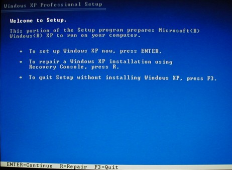

In the following screen you will have some options to choose from:
Press R to enter Repair if you intend to repair the boot sector, using FIXMBR and or FIXBOOT.
Windows will ask you for the Administrator's password. If you do not have one just press enter.
When this is done, type EXIT . Reboot your machine. This time let it boot from the HDD.
With a bit of luck you system would be fix. Remove your Install CD and keep it safe.
The other options in the screen are: Install the OS or Exit.

Thank you Lito. Unfortunately I cannot do that.
I do have the BIOS set to boot from CD and it does. But the Windows CD starts, loads a bunch of files and stops at the blue screen with "Windows Setup" at the top and "Starting Windows" in the white band at the bottom. It then freezes there. It never gets to the screen in your last picture, so I can't press R for repair or do anything else.
I can't get anything other than Linux to run, so no, I can't use a recovery CD or anything else. The only CD that works is Ultimate Boot with TestDisk on it. This is true with both the original HD and with a brand new unformatted HD fresh out of the box.
I am guessing there is a fault in the computer that prevents it from running Windows but not Linux. I was hoping I might be able to use TestDisk or some other Linux-based tool to diagnose it.
