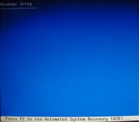

Next you should see something like this in your screen:

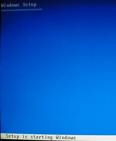

Next you should see similar screens to this:
Windows is loading  stuff...
This is the Starting Windows you should see

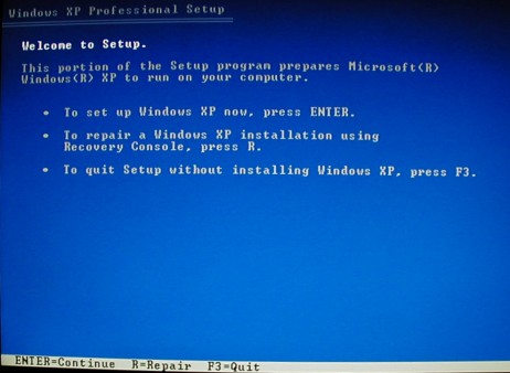

You should get here if your Windows CD booted properly.

In the following screen you will have some options to choose from:
Press R to enter Repair if you intend to repair the boot sector, using FIXMBR and or FIXBOOT.
Windows will ask you for the Administrator's password. If you do not have one just press enter.
When this is done, type EXIT . Reboot your machine. This time let it boot from the HDD.
With a bit of luck you system would be fix. Remove your Install CD and keep it safe.
To exit without doing anything Press F3 two times...
The other options in the screen are: Install the OS or Exit.

I do have the BIOS set to boot from CD and it does. But the Windows CD starts, loads a bunch of files and stops at the blue screen with "Windows Setup" at the top and "Starting Windows" in the white band at the bottom. It then freezes there. It never gets to the screen in your last picture, so I can't press R for repair or do anything else.
I can't get anything other than Linux to run, so no, I can't use a recovery CD or anything else. The only CD that works is Ultimate Boot with TestDisk on it. This is true with both the original HD and with a brand new unformatted HD fresh out of the box.
