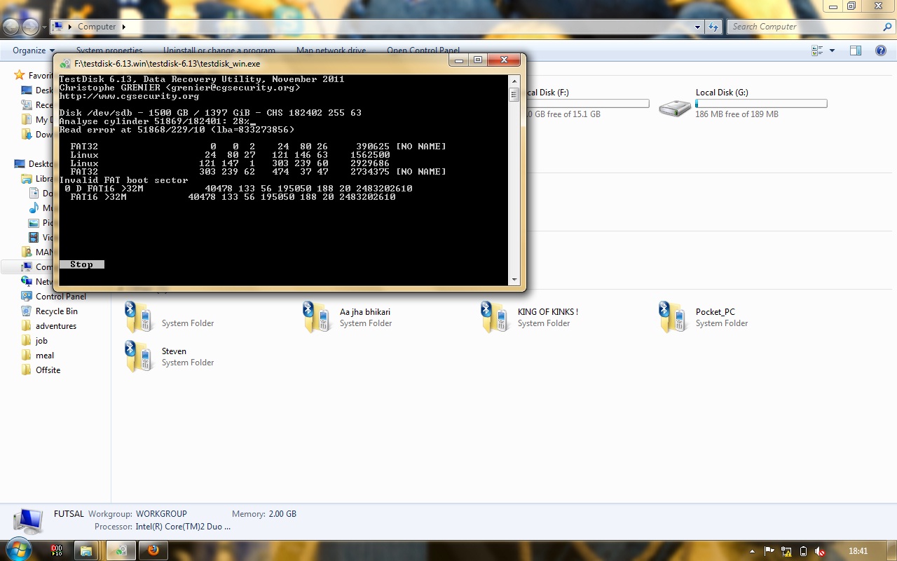

Re: need to recover lost data
im confused. im not tech savvy. i am sorry.
now when i connect my ext hd it shows up as two drives on my computer
local disk G- 186 mb free of 189 mb
local disk H - 1.30 gb free of 1.30 gb
i cannot view the 1.5 tb drive. i feel that the data (500 gb) should be there. but i cannot be seen. please check the attachments and let me know.
will it help to rebuild the bs?
any help would be greatly appreciated.
A boot sector diagnose doesn't help.
You should have a look for your previous partitions first, before you diagnose any boot sector.
I'd need infos form Analyse, Quick and Deeper Search.
Analyse is your current partition table and displayes your current partitions.
Also if something would be wrong.
Quick Search scans your disk for partitions using the boot sector.
Deeper Search searches additional for partitions using a backup from your boot sector.
Do you have any idea how many partitions did you have before and what kind of?
Because I've seen some Linux-partitions in TestDisk in the menu Advanced also.

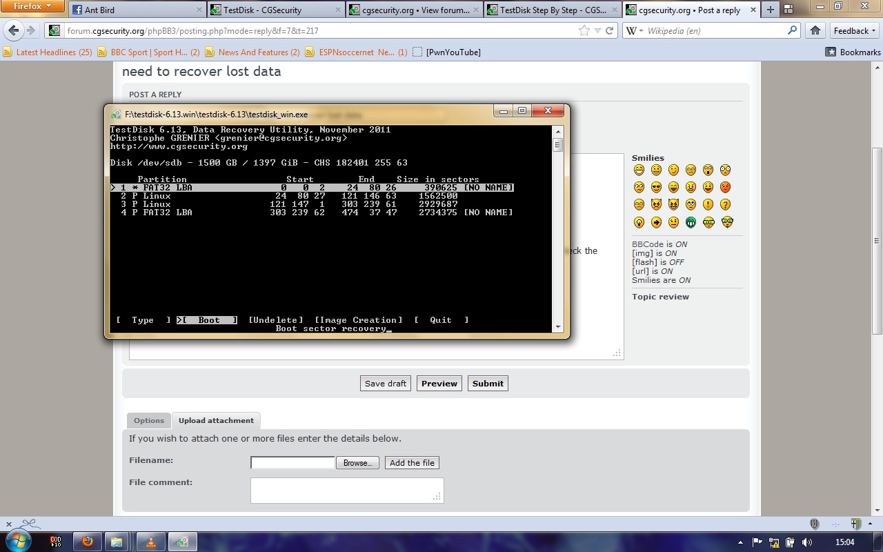

have a look at this......
only 7 % completed...
btw.. i have already tried recovery software ...Recuva, PC Inspector.. but nothing !
- disktest2 - boot sector.jpg (213.18 KiB) Viewed 13659 times
Nothing useful until yet.
Important is after the scan your result!
More important might be probably Deeper Search, because if your boot sector is overridden, then to have a try to find your partition using its backup.

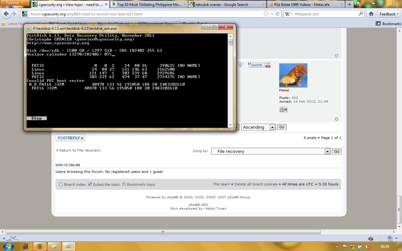

i tried the quick search.. but it got stuck after a while.. with a read access error.
tried it a few times.. no use.
test disk as of now. i am doing the deeper search now. will let you know the results later.

Sat Mar 24 18:43:46 2012
OS: Windows 7 (7600)
disk_get_size_win32 IOCTL_DISK_GET_LENGTH_INFO(\\.\C:)=75392614400
disk_get_size_win32 IOCTL_DISK_GET_LENGTH_INFO(\\.\D:)=158306664448
disk_get_size_win32 IOCTL_DISK_GET_LENGTH_INFO(\\.\F:)=16251879424
disk_get_size_win32 IOCTL_DISK_GET_LENGTH_INFO(\\.\G:)=200000000
disk_get_size_win32 IOCTL_DISK_GET_LENGTH_INFO(\\.\H:)=1400000000
file_pread(4,1,buffer,488408129(30401/254/63)) lseek err Invalid argument
file_pread(5,1,buffer,2930288129(182401/254/63)) lseek err Invalid argument
Disk /dev/sda - 250 GB / 232 GiB - CHS 30401 255 63, sector size=512 - WDC WD2500BEVS-60UST0, S/N:2020202057202d44585758453730303332383432, FW:01.01A01
Disk /dev/sdb - 1500 GB / 1397 GiB - CHS 182401 255 63, sector size=512 - SAMSUNG HD154UI, S/N:801130168383
Disk /dev/sdb - 1500 GB / 1397 GiB - SAMSUNG HD154UI
Analyse Disk /dev/sdb - 1500 GB / 1397 GiB - CHS 182401 255 63
Geometry from i386 MBR: head=240 sector=63
FAT32 at 0/0/2
Info: size boot_sector 390625, partition 390625
FAT1 : 32-793
FAT2 : 794-1555
start_rootdir : 1556 root cluster : 2
Data : 1556-390623
sectors : 390625
cluster_size : 4
no_of_cluster : 97267 (2 - 97268)
fat_length 762 calculated 760
FAT32 at 303/239/62
Info: size boot_sector 2734375, partition 2734375
FAT1 : 32-2699
FAT2 : 2700-5367
start_rootdir : 5368 root cluster : 2
Data : 5368-2734367
sectors : 2734375
cluster_size : 8
no_of_cluster : 341125 (2 - 341126)
fat_length 2668 calculated 2666
1 * FAT32 LBA 0 0 2 24 80 26 390625 [NO NAME]
2 P Linux 24 80 27 121 146 63 1562500
3 P Linux 121 147 1 303 239 61 2929687
4 P FAT32 LBA 303 239 62 474 37 47 2734375 [NO NAME]
Ask the user for vista mode
Computes LBA from CHS for Disk /dev/sdb - 1500 GB / 1397 GiB - CHS 182402 255 63
search_vista_part: 1
FAT32 at 0/0/2
FAT1 : 32-793
FAT2 : 794-1555
Data : 1556-390623
sectors : 390625
cluster_size : 4
FAT32 at 0/0/2
FAT32 0 0 2 24 80 26 390625 [NO NAME]
FAT32, 200 MB / 190 MiB
recover_EXT2: s_block_group_nr=0/95, s_mnt_count=6/30, s_blocks_per_group=8192, s_inodes_per_group=4072
recover_EXT2: s_blocks_count 781250
recover_EXT2: part_size 1562500
EXT4 Sparse superblock Recover, 800 MB / 762 MiB
recover_EXT2: s_block_group_nr=0/178, s_mnt_count=7/30, s_blocks_per_group=8192, s_inodes_per_group=4096
recover_EXT2: s_blocks_count 1464843
recover_EXT2: part_size 2929686
Linux 121 147 1 303 239 60 2929686
EXT4 Sparse superblock Recover, 1499 MB / 1430 MiB
FAT32 at 303/239/62
FAT1 : 32-2699
FAT2 : 2700-5367
Data : 5368-2734367
sectors : 2734375
cluster_size : 8
FAT32 at 303/239/62
FAT32 303 239 62 474 37 47 2734375 [NO NAME]
FAT32, 1400 MB / 1335 MiB
FAT32 0 0 2 24 254 63 401624 [NO NAME]
FAT32, 205 MB / 196 MiB
Linux 24 80 27 121 254 63 1569304
EXT4 Sparse superblock Recover, 803 MB / 766 MiB
Linux 121 147 1 303 254 63 2930634
EXT4 Sparse superblock Recover, 1500 MB / 1430 MiB
FAT32 303 239 62 474 254 63 2748062 [NO NAME]
FAT32, 1407 MB / 1341 MiB
dir_partition inode=0
FAT: cluster=2(0x2), pos=1557
1754 -rwxr-xr-x 0 0 282624 7-Mar-2012 02:03 flashing_boot.img
111 -rwxr-xr-x 0 0 38356 25-Feb-2012 21:27 MLO
130 -rwxr-xr-x 0 0 179812 25-Feb-2012 21:27 u-boot.bin
218 -rwxr-xr-x 0 0 3115008 26-Feb-2012 02:18 boot.img
1740 drwxr-xr-x 0 0 0 6-Mar-2012 00:52 LOST.DIR
1741 drwxr-xr-x 0 0 0 6-Mar-2012 00:52 .android_secure
1742 drwxr-xr-x 0 0 0 6-Mar-2012 00:52 Android
X 1754 -rwxr-xr-x 0 0 282624 7-Mar-2012 02:27 _OUTPU~1
fat_copy dst=/testdisk-6.13/_OUTPU~1 first_cluster=1754 (8564) size=282624

Sat Mar 24 23:12:34 2012
FAT32 at 0/0/2
FAT1 : 32-793
FAT2 : 794-1555
Data : 1556-390623
sectors : 390625
cluster_size : 4
FAT32 at 303/239/62
FAT1 : 32-2699
FAT2 : 2700-5367
Data : 5368-2734367
sectors : 2734375
cluster_size : 8
Sun Mar 25 01:04:18 2012
FAT32 at 0/0/2
FAT1 : 32-793
FAT2 : 794-1555
Data : 1556-390623
sectors : 390625
cluster_size : 4
FAT32 at 303/239/62
FAT1 : 32-2699
FAT2 : 2700-5367
Data : 5368-2734367
sectors : 2734375
cluster_size : 8
FAT32 at 0/0/2
FAT1 : 32-793
FAT2 : 794-1555
Data : 1556-390623
sectors : 390625
cluster_size : 4
FAT32 at 303/239/62
FAT1 : 32-2699
FAT2 : 2700-5367
Data : 5368-2734367
sectors : 2734375
cluster_size : 8
FAT32 at 0/0/2
FAT1 : 32-793
FAT2 : 794-1555
Data : 1556-390623
sectors : 390625
cluster_size : 4
FAT32 at 0/0/2
FAT32 at 303/239/62
FAT1 : 32-2699
FAT2 : 2700-5367
Data : 5368-2734367
sectors : 2734375
cluster_size : 8
FAT32 at 303/239/62
3 drwxr-xr-x 0 0 0 24-Mar-2012 22:56 $RECYCLE.BIN
dir_partition inode=3
FAT: cluster=3(0x3), pos=1561
Directory /$RECYCLE.BIN
3 drwxr-xr-x 0 0 0 24-Mar-2012 22:56 .
0 drwxr-xr-x 0 0 0 24-Mar-2012 22:56 ..
4 -rwxr-xr-x 0 0 129 24-Mar-2012 22:56 DESKTOP.INI

interface_load
Disk /dev/sdb - 1500 GB / 1397 GiB - CHS 182401 255 63 Sat Mar 24 15:50:55 2012
FAT32 at 0/0/2
FAT1 : 32-793
FAT2 : 794-1555
Data : 1556-390623
sectors : 390625
cluster_size : 4
FAT32 at 0/0/2
FAT32 at 303/239/62
FAT1 : 32-2699
FAT2 : 2700-5367
Data : 5368-2734367
sectors : 2734375
cluster_size : 8
FAT32 at 303/239/62
dir_partition inode=1740
FAT: cluster=1740(0x6cc), pos=8509
Directory /LOST.DIR
1740 drwxr-xr-x 0 0 0 6-Mar-2012 00:52 .
0 drwxr-xr-x 0 0 0 6-Mar-2012 00:52 ..
1 P FAT32 0 0 2 24 254 63 401624 [NO NAME]
Sat Mar 24 16:03:00 2012
FAT32 at 0/0/2
FAT1 : 32-793
FAT2 : 794-1555
Data : 1556-390623
sectors : 390625
cluster_size : 4
FAT32 at 303/239/62
FAT1 : 32-2699
FAT2 : 2700-5367
Data : 5368-2734367
sectors : 2734375
cluster_size : 8
FAT32 at 0/0/2
FAT1 : 32-793
FAT2 : 794-1555
Data : 1556-390623
sectors : 390625
cluster_size : 4
FAT32 at 303/239/62
FAT1 : 32-2699
FAT2 : 2700-5367
Data : 5368-2734367
sectors : 2734375
cluster_size : 8

Data : 5368-2734367
sectors : 2734375
cluster_size : 8
FAT32 at 303/239/62
FAT32 at 0/0/2
FAT1 : 32-793
FAT2 : 794-1555
Data : 1556-390623
sectors : 390625
cluster_size : 4
FAT32 at 303/239/62
FAT1 : 32-2699
FAT2 : 2700-5367
Data : 5368-2734367
sectors : 2734375
cluster_size : 8
FAT32 at 0/0/2
FAT1 : 32-793
FAT2 : 794-1555
Data : 1556-390623
sectors : 390625
cluster_size : 4
FAT32 at 303/239/62
FAT1 : 32-2699
FAT2 : 2700-5367
Data : 5368-2734367
sectors : 2734375
cluster_size : 8
FAT32 at 0/0/2
FAT1 : 32-793
FAT2 : 794-1555
Data : 1556-390623
sectors : 390625
cluster_size : 4
FAT32 at 303/239/62
FAT1 : 32-2699
FAT2 : 2700-5367
Data : 5368-2734367
sectors : 2734375
cluster_size : 8
FAT32 at 0/0/2
FAT1 : 32-793
FAT2 : 794-1555
Data : 1556-390623
sectors : 390625
cluster_size : 4
FAT32 at 0/0/2
FAT32 at 303/239/62
FAT1 : 32-2699
FAT2 : 2700-5367
Data : 5368-2734367
sectors : 2734375
cluster_size : 8
FAT32 at 303/239/62
interface_load
FAT32 at 0/0/2
FAT1 : 32-793
FAT2 : 794-1555
Data : 1556-390623
sectors : 390625
cluster_size : 4
FAT32 at 0/0/2
FAT32 at 303/239/62
FAT1 : 32-2699
FAT2 : 2700-5367
Data : 5368-2734367
sectors : 2734375
cluster_size : 8
FAT32 at 303/239/62
Directory /LOST.DIR
even the deeper search hangs around the same time. what should i do.. ?
what option do i have?
