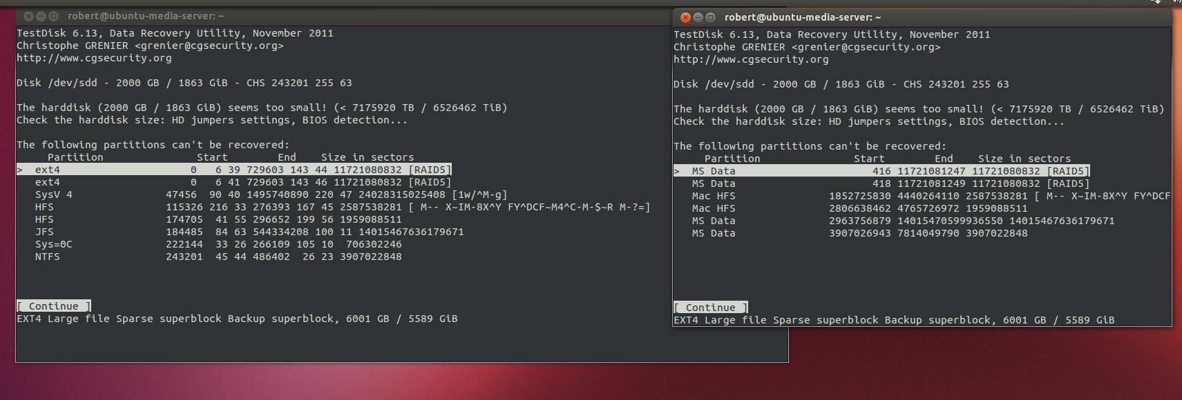

I ran a deep scan with both "None" and "EPI GPT" here's the result of that:
However I had to turn of the pc and that deepscan ran for atleast a day and a half.
The correct (or rather the partition I would like to restore) is the ext4 RAID5 one.
Would you be so kind as to instruct me how to go about doing this?
Greetings, Rope.
P.S. I get a "Can't open filesystem. Filesystem seems damaged." error when I try to list the partition which is found with a quick search.
Left: None, <br />Right: EPI GPT
Left: None,
Right: EPI GPT

TestDisk displays your partition with a size of 6 TB.
But if you watch TestDisk and your disk, the size is only 2 TB.
For a succesful recovery, you'll need an intact array.
Did you accidentally format your disk from ext4 to fat32 or NTFS?
