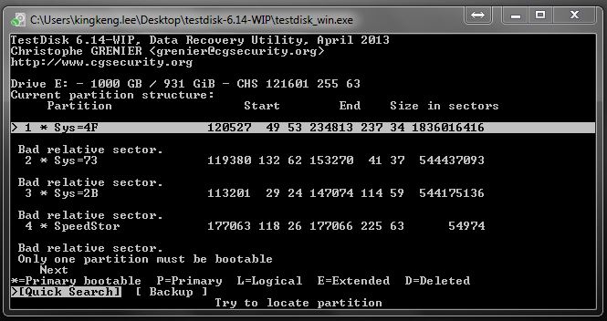

Hi I think I should provide more information to help to diagnose the problem:
I started testdisk, after create log this is what I see:
Disk capacity of 1000GB is correct.
Then, it shows:
Funny thing is, when I run this with my laptop (Window Vista) it auto detect it as [Intel], but with my PC (Window 7) it detected [None]. I have not partitioned this disk and [None] should be the correct choice? I have selected [Intel] as what I did with my laptop.
Then I select "Advanced" and I see:
Snap3 - Advance.JPG (46.64 KiB) Viewed 6124 times
I don't seems to be able to do anything so I go back to the previous menu and selected "Analyse", and I see again:
can't attached anymore screenshot... to be continue.

After I select 'Analyse' I see:
Snap4 - Analyse.JPG (62.23 KiB) Viewed 6124 times
and follow by "Quick Search", after that the search jump quickly to 10/121600 as shown:
Snap5 - Quick Search.JPG (35.45 KiB) Viewed 6124 times
And it seems to take forever to advance from here, is it normal? Normally how long does it take to analyse the whole 1T disk?
Please help to advise if I am going along the right path.
Thanks a lot!

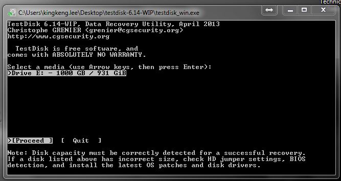

kkgorilla
Posts: 6
Joined: 18 Apr 2013, 05:21
Re: Portable Harddisk became RAW
#6 Post by kkgorilla »
Hi Fiona, thanks for replying.
I am using two computer to work here, one is my personal laptop running on Vista 32bit and the other is my office pc running on Window 7 64bit. The TestDisk I used is 32bit in both case.
In the disk selection, as you can see from my first attached screenshot, I only get to choose "Drive E:". I did not use any encryption.
Thank you.
