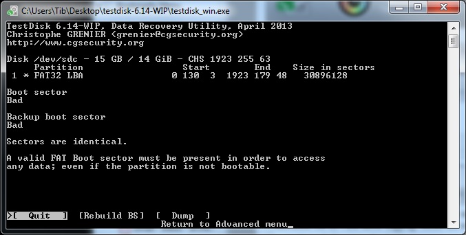

I rebooted my phone earlier and it came back up asking if I wanted to format my SD because it was blank. This confused me so I did some digging, which led me to this tool (seriously, every other post I saw referred to testdisk). I went through the steps for fat32 recovery, and tried to do a rebuild of the boot sector - which is appears what went belly up - but it never fixes it. It will run through the 'rebuild bs' check, then dumps me back to a screen where it says both the boot and backup are bad, and identical, and that's it. I'm stuck.
I'd really like to NOT lose this data, I've got pictures from my sister's wedding, data and etc of my own that I need, and more. I ran the photorec option which finds a ton of stuff so I'm sure it's still all there, I just need to repair the tables.
Attached is a screenshot showing what happens after having run 'Rebuild BS' - if I do a Dump, there's nothing but a solid screen of 'ffffffff' for both sides (primary and backup boot sectors).

I've taken a dd image of the drive, and as mentioned before run photorec against it and pulled out lots of data. Is it possible perhaps to format it cleanly, then do a dd back from my image but only get the actual data parts and skip the initial/corrupt blocks of data? Where does that bit end and the rest of it start though?
