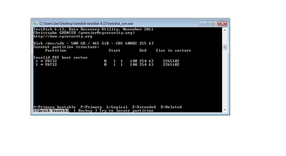

Please confirm in TestDisk through until you see the menu Analyse (your affected disk must be selected).
Would it be possible to upload a screenshot from Analyse (there should be a description "current partition structur").

Here's the page after "Analyze"
Re: help repairing FAT32 external HD
#4 Post by Fiona »
I assumed that your partition might be wrong?
That's why the menu Advanced cannot work correctly.
Your current partition size is only 1 GB out of 500 GB.
It's advisable tu run Quick Search and if nothing will be found Deeper Search also.
On your last screen press enter to start Quick Search.
If there starts a question about vista, press enter to proceed.
I'd need the screen if Quick Search is finished.
You can recognize it, if you see "Result".

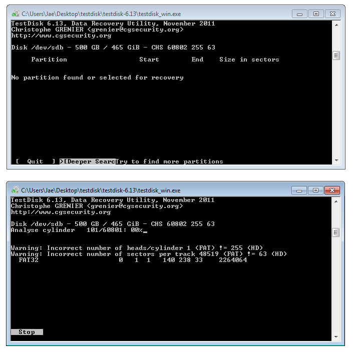

Finished quick search. Here are the results. I started deeper search as a result.
#8 Post by Fiona »
Please run Deeper Search.
If the scan is finished, please upload a screen.
Don't press enter to proceed.
Don't close TestDisk. otherwise it might be possible that you must repeat that scan.
If a partition is found, please check it and press p to list files.
To go back to the previous screen, press q for Quit.
Please let me know, did you see your files or an error message?

Deeper search just finished. Screen picture is attached.
I can see my files when I press "p", though some of them are colored red, while others are white. How should I proceed?
deeper search results.png (17.88 KiB) Viewed 18993 times
#10 Post by Fiona »
Your partition is too small!
Only 1 GB.
I assume that you used your complete space before?
