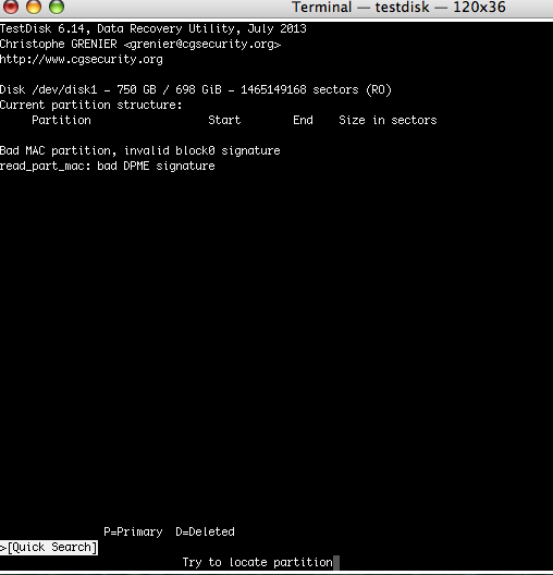

Next step it is also a bit confusing because I have a MacBook (Mac OS X 10.5.8, Intel Core), so it should be a mac partition detected but instead it is an EFI GTP one (perhaps the one I was creating).

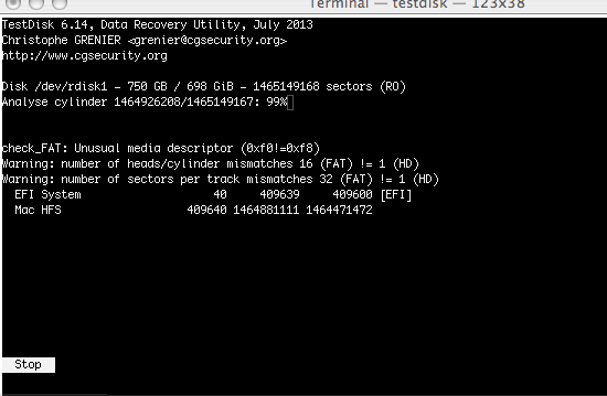

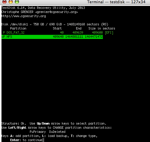

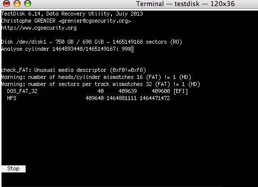

I decided to try first with Mac and do a quick search. TestDisk detects my lost partition but I cannot list the files in that partition and an error appears and I am not able to go futher. I did also a deeper search which took almost 24h and I got no new partitions after that.

If I select EFI for the partition search instead of Mac, something similar appears, and I never can have access to the files in the partition.

Use EFI GPT and not Mac in your case for the partition table. Can you post the new screenshots or the testdisk.log file ?

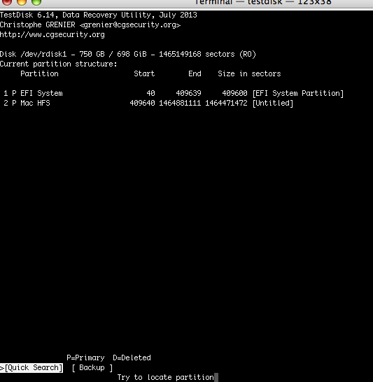

Ok, I chose rdisk and EFI Partition.
Then I : [Analyze] Analyse current partition...
Afterwards appear the following:
And I press Quick search:
And finally I get two partitions:

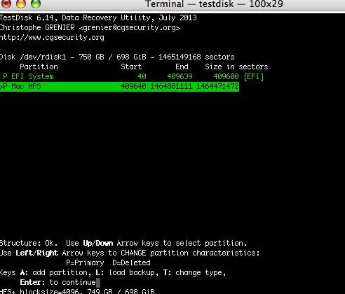

EFI: so small but I have the option fo listing files, although when pressing "P" I get this error message: "No file found, filesystem may be damaged.
Mac: I can not list files and if I click in that partition, it ask me for deeper search but I only get numbers and numbers but anything else:

Re: Found partition but cannot list files or recover it
#4 Post by cgrenier »
There is a partition on the disk. If a partition has been deleted, a new one has been created over it and the partition reformated. Try to recover your files with PhotoRec.
