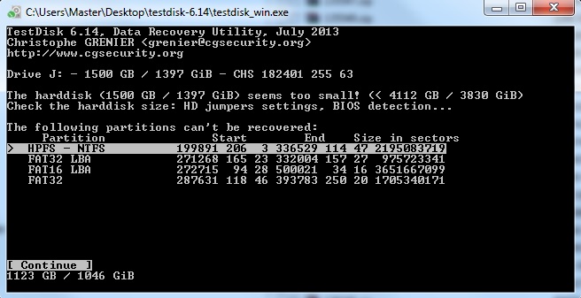

5. No Partitions Are Found, [Quick Search]
5.1. [Quick Search] & [Deeper Search] Results
[Intel] - [Quick Search] - [Deeper Search].jpg (66.28 KiB) Viewed 8851 times

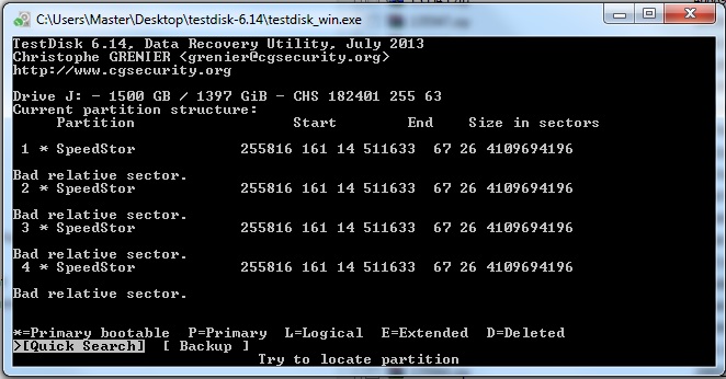

5.2. Re-Entry to [Quick Search] shows the following:
[Intel] - [Quick Search] 2nd Entry.jpg (85.32 KiB) Viewed 8851 times
6. [Options]
6.1. Enable Expert Mode
7. [Advanced]
7.1. A Single Partition is Listed
7.2. "1 * SpeedStor 255816 161 14 511633 67 26 4109694196"
7.3. No [Boot] Option Exists
8. [Type]
8.1. [Type] is currently set to [f4]

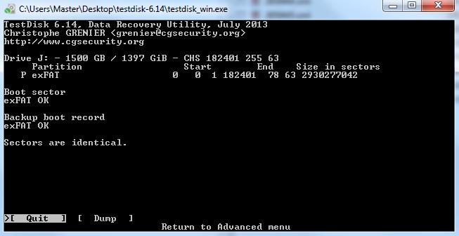

10.2. **Please Note Selecting
  • Crashes Software**
    This has been my stopping point before further scouring this forum for situations similar to mine concerning exFAT - none of which to this point are similar at all what-so-ever. I have no idea how to proceed, my conditions seem unique. Please troubleshoot me. I'm open to Ideas and to further providing information that may help repair the Hard Drive, if possible. I anticipated failure from the get-go and already began recovery via other means.

When "Drive J:" was selected, partition table type defaults to None, it's the correct setting.
By forcing the choice to Intel, the user has forced TestDisk to interpret the boot sector content as Intel partition table entries, it's why bogus partitions are listed.
To search for lost partitions always select a PhysicalDisk, not a drive letter. In this case, the partition table is ok, so it wasn't necessary.
Listed in 10.2, TestDisk crashed when parsing the corrupted exFAT filesystem. Unless you provide some information like the exact error message, stackdump trace..., the problem can't hardly be fixed.
