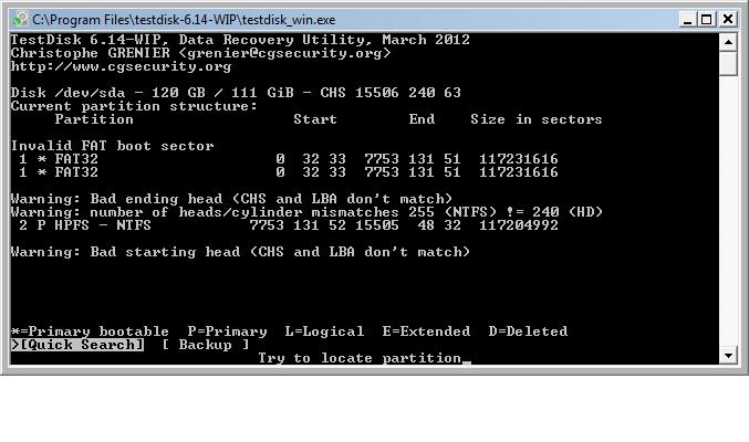

I have a 120 gb HD consisting 8 gb PQSERVICE partition, 56 gb each of C: and D:. I wrongly issued a diskpart "clean" (not "clean all") and now only C: and D: are visible when I list disk and in windows disk management. I ran TestDisk and a message "Warning: the current no. of heads per cylinder is 255 but the correct value may be 128...."
Below is an image of the test result:
Please let me know what should I do next. Thanks.

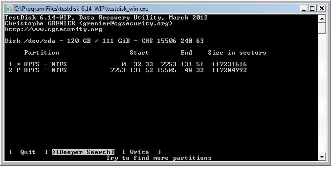

Re: Recover from Diskpart "Clean" (not clean all)
This are the images you asked for:

- QuickSearch.jpg (32.16 KiB) Viewed 26064 times
- Analyse240Heads.jpg (45.29 KiB) Viewed 26064 times
Using 240 heads provides another partition didn't found on 255 heads.
Did you check that partition pressing p to list your data?
As far as I've seen there is no PQMagic-partition.
Should it be 3 partitons, altogether?
Also, both partititions using the whole space from your disk.
In case, if there is still something wrong, please run Deeper Search on 240 heads.
