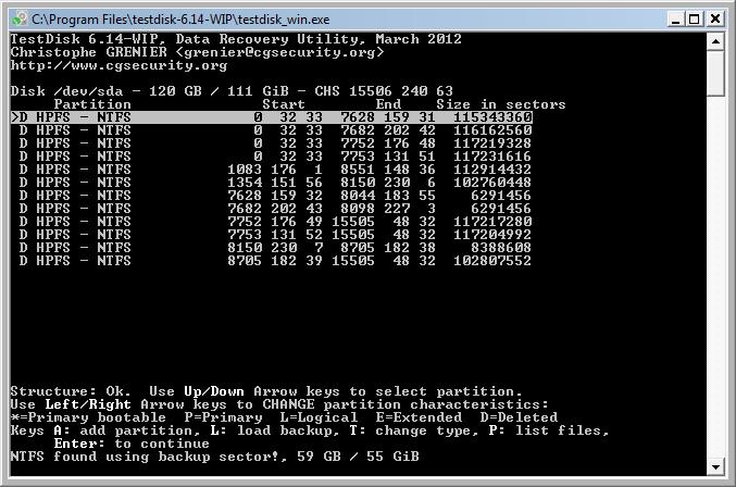

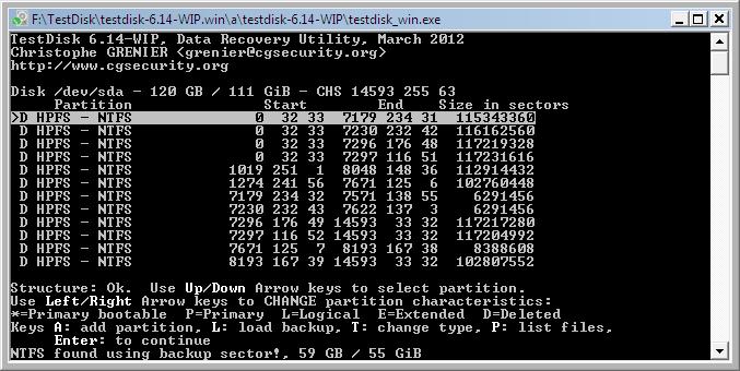

I have a 120 gb HD consisting 8 gb PQSERVICE partition, 56 gb each of C: and D:. I wrongly issued a diskpart "clean" (not "clean all") and now only C: and D: are visible when I list disk and in windows disk management. I ran TestDisk and a message "Warning: the current no. of heads per cylinder is 255 but the correct value may be 128...."
Below is an image of the test result:
Please let me know what should I do next. Thanks.

Re: Recover from Diskpart "Clean" (not clean all)
Posted: 02 Apr 2012, 20:41
If something is overridden and the file system damaged, it'd be safe to use datarecovery software.
But in your case, can you repeat your diagnose using 240 heads per cylinder?
Probably TestDisk can find your right partition, using its backup of the boot sector?
Infos;
http://www.cgsecurity.org/wiki/Menu_Geometry
Confirm in TestDisk through until you see the menu Analyse.
Your affected disk must be selected and partition table type Intel chosen.
Don't confirm at Analyse, but Geometry!
Check Heads.
Change the value to 240.
Press enter.
Check OK and hit enter to leave the menu.
Go to Analyse and repeat your Diagnose.
Upload a screen from Analyse (the current partition structur) and a screen from Quick Search (Result).
Further information will follow.
It's only a diagnose, you'll not change anything.
Vista/Win7 partitions are aligned on megabyte boundary and not Intel-Standard on Cylinder boundary.
Sometimes, it's necessary to use deeper search, that TestDisk finds Win7-partitions.

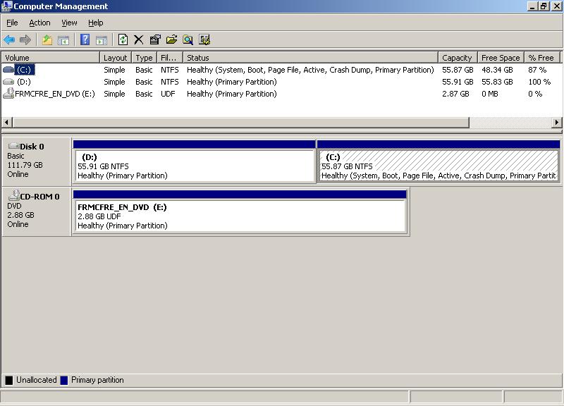

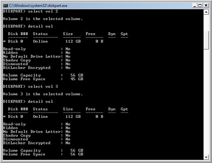

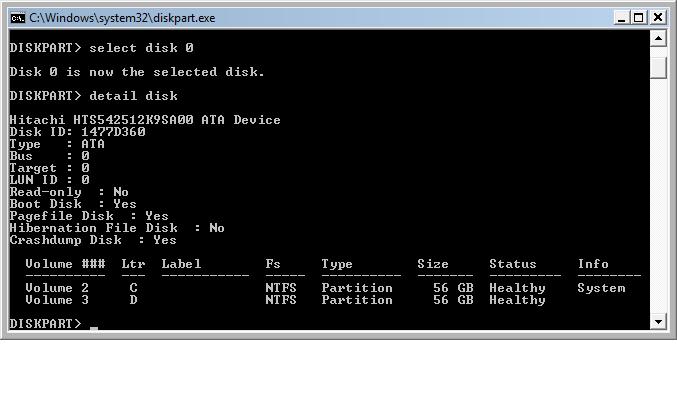

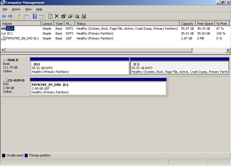

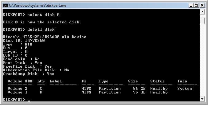

FYI OS is Vista Home Basic which is at C:. and D: is empty. 8 gb PQSERVICE is the hidden partition which I wish to recover. You will notice Disk 0 displays only Vol 2 and 3, no Vol 0 or 1 which I think is where the missing PQSERVICE partition is. Images attached:

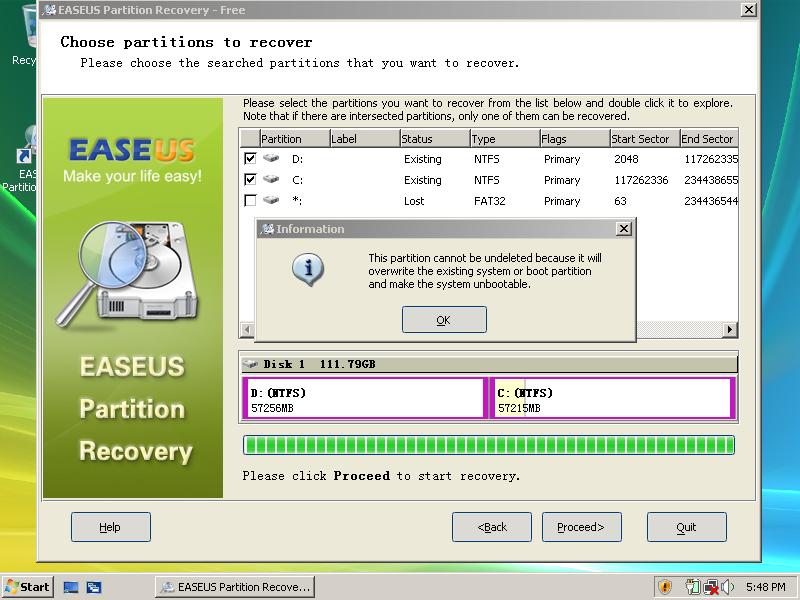

More images for your investigation here if of use. The "Lost" FAT32 partition is the target. Please help me to dig it out in one piece from this mess if you can
