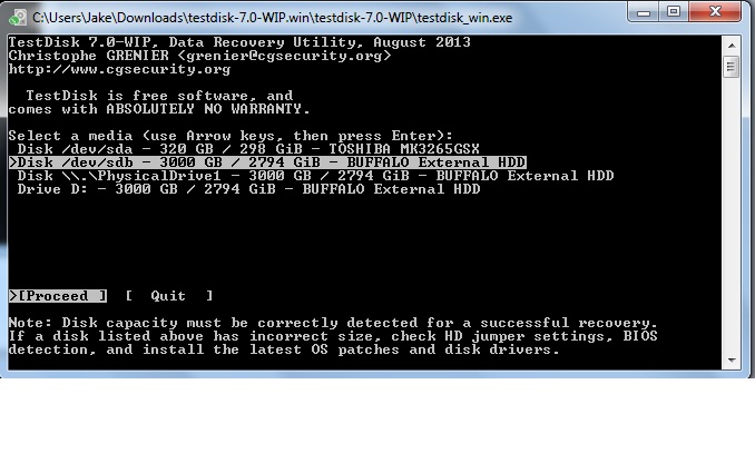

When I used the TD 7 version which you suggested, upon TD startup there were 4 disks available, whereas on the TD 6 version, there was only 3 (the one on the bottom was the additional one in version TD 7). (Screenshot 1)
Ignoring the bottom option, I tried writing on both the second and third from top options. But when selecting either of them the message "no bootable partition" comes up (screen 2).

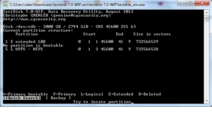

However, when I did this on the 3rd from top option, the result after the "write" is completely different. I restarted my computer and the Error message from Screenshot 3 came up. And then when I went in to the properties of the drive (screenshot 4) there is absolutely nothing.

here is screenshot 1
the drives which show up on TD when it opens
