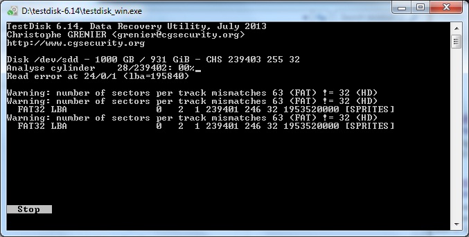

I have a problem with my external drive and could not access it but then I found this wonderful software that I believe could help me.
I managed to get this part (see attached) and still going for deeper search..
Previously I try to get the listed files and I can see some of folders and files ae there but I found some of them is not accessible,or it was saying no file found or system damage. Sound scary to me...
So I went to deepr search to get any better result or solution that software can offer...
While I'm waiting for the results.. there something that I need to pay attention on this data corruption here?
I attached my log to see if you guys can help to find any clue what was going wrong with my hard drive so I can check and investigates further...
Thank You!

- deeper-search.jpg (68.65 KiB) Viewed 7595 times

Your disk geometry looks wrong!
The value is 32 but should be 63.
You can use the geometry menu to change the value.
Confirm in testdisk through until you get to Analyse.
Don't confirm at Analyse.
Mark the menu geometry.
Mark Sectors and change it from 32 to 63.
Confirm with OK to leave the menu geometry.
Repeat your diagnose and copy and paste the content of your testdisk.log.
You'll find your testdisk.log in your testdisk folder.
This can improve your results.

Hi Fiona,
Thank you for you prompt reply...
I changed the sector to 63. Now I'm doing analysis and do the quick search...
While waiting... here'e the first shot of anlyses..

Disk /dev/sdc - 1000 GB / 931 GiB - CHS 484506 64 63
1 E extended LBA 0 0 33 484504 3 3 1953520288
Warning: number of heads/cylinder mismatches 255 (FAT) != 64 (HD)
5 L FAT32 LBA 0 1 2 484503 62 62 1953520000 [SPRITES]
*=Primary bootable P=Primary L=Logical E=Extended D=Deleted
>[Quick Search] [ Backup ]

Your partition values don't match.
L FAT32 LBA 0 1 2 121600 254 62 1953520000 [SPRITES]
The values 2 and 62 are not Intel standard.
In your case I'd suggest to copy your files to another disk or healthy partition.
If you list your files you can copy them to another disk/partition.
At the bottom of the screen you'll find the copy commands.
To choose another directory, you can mark these to dots on the upper area of the screen and press enter, until you get to your disk selection.
You can select another disk or partition where you'd like to copy your data to.
To copy your data into a folder you can mark an appropriate folder and enter it by pressing the right arrow key.
If you'd like to recover your partition.
Only if you were able to list your data!
It means your screenshot here;
http://forum.cgsecurity.org/phpBB3/down ... hp?id=1801
you should set it from L for logical to P for primary using your left or right arrow key on your keyboard.
Otherwise you can't recover your partition, because it doesn't match.
Then, press enter to get to tzhe next screen.
Mark "Write" and confirm with enter.
If there would be a message about your boot sector, you can confirm it with backup bs.
But only in case.
Quit TestDisk and restart your PC.
