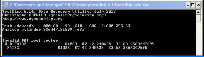

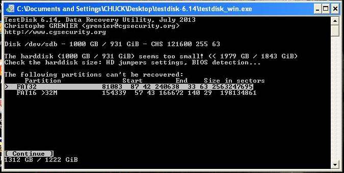

My wife the hairdresser got what my Device Manager calls a LaCie d2 Quadra v3 USB Device (used) for free from one of her clients. It's a silver upright tower ext HD with one big blue pushbutton/blue light indicator on the front. The LaCie website did not recognize the serial no., and I am assuming it is a 1TB drive. Her winXP laptop wouldn't mount it so I tried it on my winXP desktop and got the same result. I have unplugged my regular backup drive so that the LaCie is the only ext HD on my system. I searched the forums, and tried a utility to clean up and remove old USB Mass Storage Drivers. It deleted a lot of stuff but it didn't magically solve the problem. I then found TestDisk and the basic tutorial, and answered all questions as shown, and got the following screens at the 68% and "finished" points. This unit is a complete black box to me and there is no data on it I want to save. A complete erasure is fine as long as utility in an winXP environment can be established. But if it won't mount, I can't do anything with it. Previous owner may have been running a Mac, though I ran this test set for Intel (PC) Any advice ?

Re: Gifted with LaCie Ext HD
I'd need info about testdisk Analyse too.
Because it's your current partition table/structur.
Then, I'd be able to judge your situation.
Also, you can copy and paste the content of your testdisk.log.
It would additional provide some info about the results in testdisk.
Until yet, I only have a screen during the scan and a message of not recoverable partitions, because they end after disk limit.

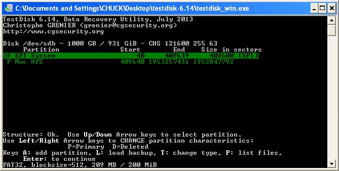

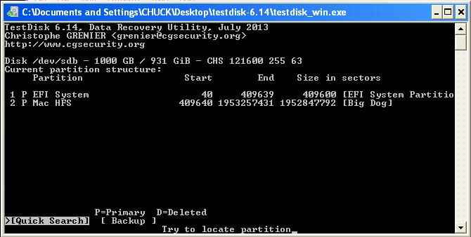

Here are the screens from my second run of TestDisk. This time, I noticed the system was telling me that it had detected an EFI GPT partition type, so I used that instead of the Intel setting, then ran the Analyse. The Intel run
had taken about two hours, but this time it was done in two minutes, most of which was spent on the last 5%.
I see the word "Mac" in there. Can an external HD previously connected to Mac OS be converted to winXP?
#4 Post by Fiona »
Now it looks like, that your disk and partition table is recognized correctly.
But it displays an Apple partition which WinXP can't mount because it's not supported.
Do you know what kind of partition did you previously have?
Has it been an FAT, NTFS or HFS+ partitoion?
