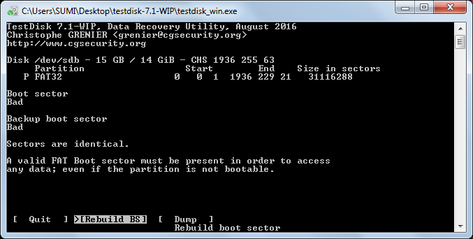

Re: Flash drive went RAW, "No Partition Found" when scanned
You should use Disk not Drive and always the 32bit version of TestDisk.
Repeat your diagnose!
If it doesn't find anything;
Try partition table type None!
Then use the menu Advanced instead of Analyse.
If your partition appears as Unknown, use Type to set your previous file system (FAT32/NTFS? howsoever?).
Use the menu Boot and Rebuild BS to have a try to rebuild your boot sector.
If it was successful, you should see the menu List.
Have a try to list your data.
If you've seen your data, you can use the menu write to write your extrapolated boot sector.
If your data are listed, you can copy/backup your data also.
At the bootom of the screen, you'll find all the copy commands.

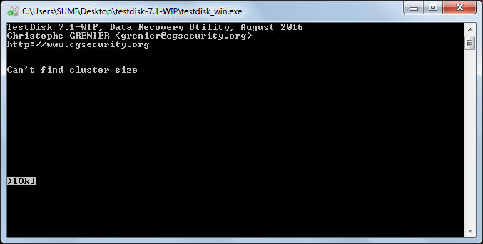

Unfortunately, having followed the directions and trying both FAT32 and NTFS (I don't think this flash drive would be anything else, unless there's a Mac specific format), I wasn't able to to proceed. On the last line of your directions, I failed instead of succeeded. The log is below:

Fiona wrote:You should use Disk not Drive and always the 32bit version of TestDisk.
After Rebuild BS it shows - Can't find cluster size then i click ok
then it shows image .
what to do now . is my sdcard operates or not? i don't wants to recover any thing.
