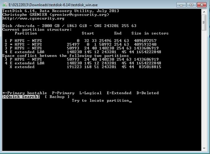

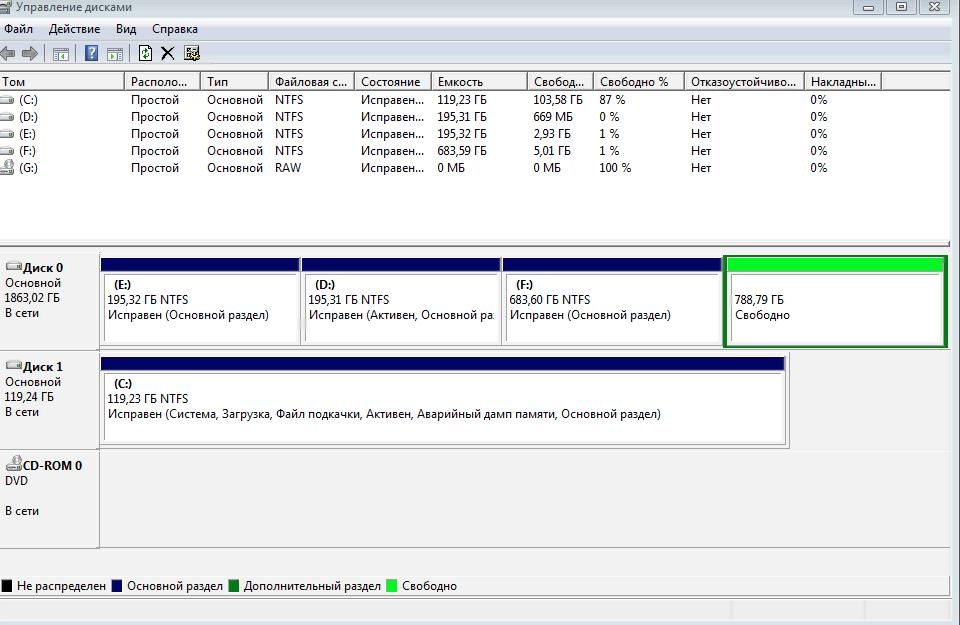

Hi! There was a problem with HDD I have. It started with the program Partition Magic something spoiled and one of the two disks that are extended drive ceased to be visible in Windows 7. I installed Windows XP, there are all the drives were visible. I did a file backup of the disk, which is not visible in windows 7. Then I wanted to remove the disc and re-create. But in the extended section 2 of section were removed. Deleted sections are in the green region. Can they recover? Here's a screenshot of the program test disc
Sincerely, Alexander
