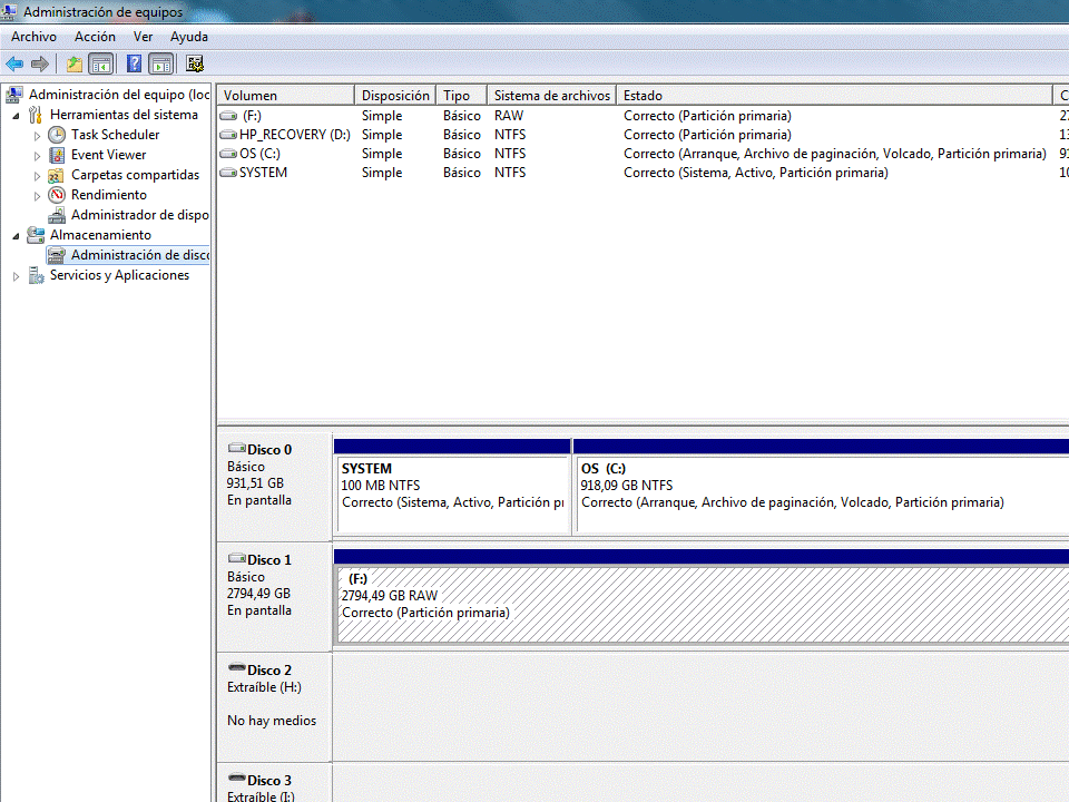

Would it be possible to upload a screen from your disk management console?

Screenshot is attached.

You uploaded a screen from your drive.
Bit it would be more precise to select your disk.
Would it be possible to upload a screen in TestDisk, where you selected your disk?
