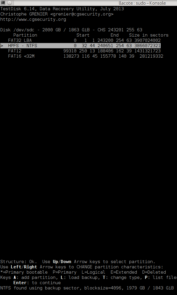

FACTS
I own an external, 2,5 inches 2TB hdd (1,8 Tio). I had it formatted as a unique NTFS partition covering nearly all space (except for a few Gio that I kept at end of disk, in case I wanted someday to install a live system).
Last week, I wanted to install the latest Ubuntu on my computer, by first putting it on a small external drive (a key of 1,8 Gio). You'll guess what happened... I chose the wrong device in the live-system creation tool and erased my 2TB.
Hopefully Testdisk is here. Following the recommandations (unmounted disk and such), I runned it. It first see the new FAT32 partition, only with Deeper Search does it see other partition. Finally, testdisk lists...
- the all new FAT32 partition;
- a HFS - NTFS partition which I suppose is my "good" partition;
- a FAT16 partition, coming from whoknowhere;
- a FAT12 partition, idem...
So news seems good, he sees a NTFS partition. Still, 2 problems.
- Testdisk displays "The Harddisk (2000 GB / 1863 GiB) seems too small! (<2422 GB / 2256 GiB)." Not sure what it means but doesn't seem very good.

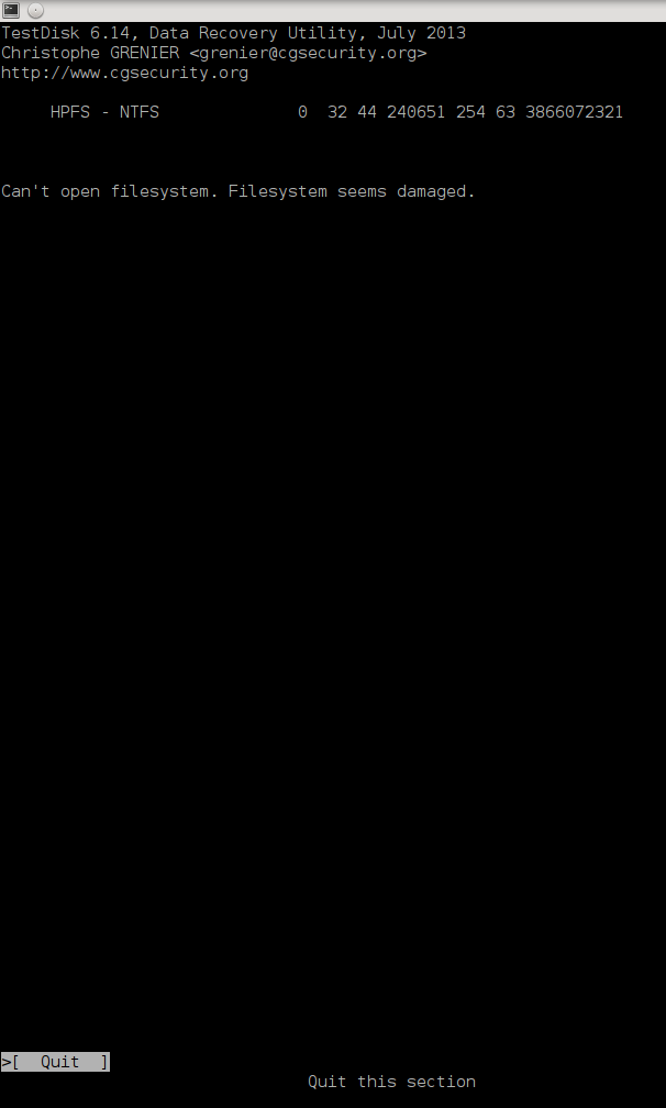

- It says "NTFS found using backup sector, blocksize=4096, 1979 GB / 1843. But when I "enter it" with P to list files, its says "Can't open filesystem. Filesystem seems damaged".
So, with this, I'm not sure what is the right next step. If any can help troubleshoot this it will be much appreciated.
The full testdisk log (2 scans with different options) and some screenshot are accessible through this link (I can attach them directly if preffered).
https://drive.google.com/folderview?id= ... sp=sharing
Thanks in advance (French version below in case of)!

EDIT : Inclusion of log and screens in opening post. The log and screens relate to the two deepsearch that I made consecutively: first with default options, second with change in cylinder boundary option.
Captures
First Deepsearch
Second Deepsearch
The ntfs partition detail was identical to the one in first deepsearch.

ntfs_mst_post_read_fixup_warn: magic: 0x471484c2 size: 1024 usa_ofs: 3420 usa_count: 462: Argument invalide
Record 0 has no FILE magic (0x471484c2)
Failed to load $MFT: Erreur d'entrée/sortie
Disk /dev/sdc - 2000 GB / 1863 GiB - CHS 243201 255 63
FAT32 at 0/1/1
FAT1 : 32-953439
FAT2 : 953440-1906847
start_rootdir : 1906848 root cluster : 2
Data : 1906848-3907023999
sectors : 3907024002
cluster_size : 32
no_of_cluster : 122034911 (2 - 122034912)
fat_length 953408 calculated 953398
FAT32 at 0/1/1
FAT32 LBA 0 1 1 243200 254 63 3907024002
FAT32, blocksize=16384, 2000 GB / 1863 GiB
FAT32 at 0/1/7
FAT1 : 32-953439
cluster_size : 32
FAT32 at 0/1/7
BAD_RS LBA=4583963460 10206756
FAT12 285338 134 49 294578 92 14 148437920
This partition ends after the disk limits. (start=4583963460, size=148437920, end=4732401379, disk end=3907029164)
BAD_RS LBA=2221363097 18446744073709551615
FAT16 <32M 138273 116 45 155778 140 39 281219332
BAD_RS LBA=1595430912 4126079
FAT12 99310 250 13 188406 162 39 1431321723
NTFS at 240651/254/63
filesystem size 3866072321
mftmirr_lcn 16
HPFS - NTFS 0 32 44 240651 254 63 3866072321
NTFS found using backup sector, blocksize=4096, 1979 GB / 1843 GiB
The harddisk (2000 GB / 1863 GiB) seems too small! (< 2422 GB / 2256 GiB)
Not an exFAT boot sector.
Can't open backup.log file: Aucun fichier ou dossier de ce type
interface_load
interface_load
New options :
Dump : No
Align partition: No
Expert mode : No
