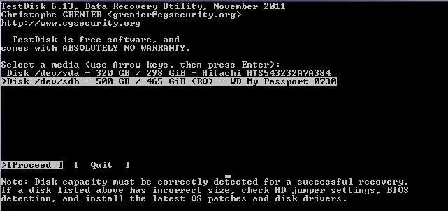

Thanks for your reply Fiona. TestDisk finally showed my external hard disk as in the attached screenshot. I have chosen the relevant disk but I think it's gonna take a while before I can use Analyse.

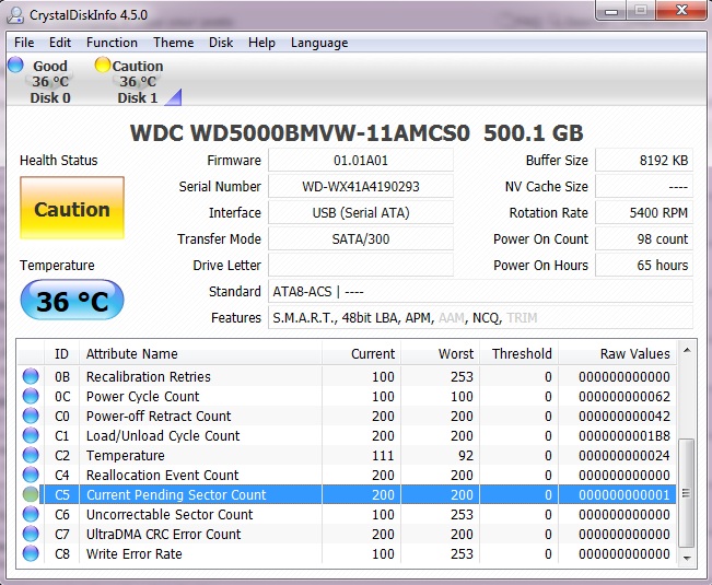

However, the other screenshot from CrystalDiskInfo showed Caution for 'Current Pending Sector Count'.
WD - crystaldiskinfo.jpg (161.36 KiB) Viewed 12593 times

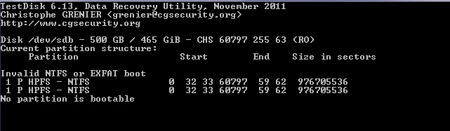

To judge your situation I'd need a screen of your partition table.
It's from Analyse your current partition structur.

Here's the result from Analyse:
WD - analyse.jpg (35.47 KiB) Viewed 12592 times

RO means read only.
Probably depend on your MacBook.
But might be ok to have a diagnose!

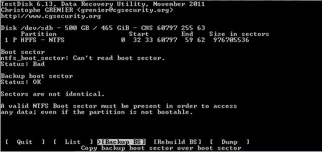

Please diagnose your boot sector.
Start TestDisk.
Confirm through until you see the menu Analyse.
Press enter at Boot.
If you see a message that your backup of your boot sector is ok and you see also the menu List, please check it and press enter to list your data.
Do you see your data or an error message?
Please let me know.
If the menu List is not available or you've seen an error message-!
Rebuild BS will be in progress.
Infos will follow.

The Advance option result in as the following screenshot:
WD - advance - boot.jpg (53.62 KiB) Viewed 12585 times
The boot sector is bad but the back up is ok. I am proceeding to list the data now.
Thank you for the guide!

The List option manage to list my data. I used Backup BS next but an error said 'Can't overwrite NTFS boot sector'.
Is this probably caused by not running TestDisk as administrator? However I have right clicked and 'run as administrator'.

CrystalDiskInfos indicated some Problems about pending sectors.
In this case it would be better to copy your data to another intact Disk using TestDisk.

It might be a better solution to copy/backup your important data first, because if you recover a damaged file system, if your OS reads an error it could hang or not response anymore.
Although your boot sector is damaged and you can repair it, it's advisavle about the CrystalDiskInfo-message to copy your data first.
