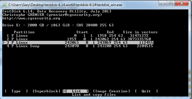

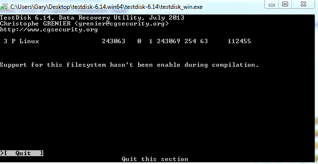

I'm new to this so please let me know if I'm not describing the issue correctly or not providing enough information.
I had a NAS device that stopped working, it was 2 disk mirrored. After it stopped working I initially thought the issue was the network interface, so I purchased a new device and using only 1 disk to see if I could get to the data without reformatting it, sadly it reformatted the disk so I only have one disk left. I purchased a USB/SATA adapter and discovered this software. I followed the step by step instructions and it looks like I did locate the partitions, see attachment A.
When I try to list the partition contents I get the error " Support for this file system hasn't been enabled during compilation. See attachment B.
Here is the log

Disk \\.\PhysicalDrive0 - 120 GB / 111 GiB - CHS 14593 255 63, sector size=512
Disk \\.\PhysicalDrive1 - 2000 GB / 1863 GiB - CHS 30400 255 63, sector size=4096
Disk \\.\PhysicalDrive2 - 203 GB / 189 GiB - CHS 24792 255 63, sector size=512
Drive C: - 119 GB / 111 GiB - CHS 14580 255 63, sector size=512
Drive D: - 513 MB / 489 MiB - CHS 122 64 32, sector size=2048
Drive E: - 2000 GB / 1863 GiB - CHS 30400 255 63, sector size=4096
Drive F: - 203 GB / 189 GiB - CHS 24791 255 63, sector size=512
Analyse Drive E: - 2000 GB / 1863 GiB - CHS 30400 255 63
check_part_i386 failed for partition type 83

No ext2, JFS, Reiser, cramfs or XFS marker
1 P Linux 0 1 1 1958 254 63 31471272
2 P Linux 1959 0 1 243062 254 63 3873335760
3 P Linux 243063 0 1 243069 254 63 112455
4 P Linux Swap 243070 0 1 243200 254 63 2104515
search_superblock
search_superblock
search_superblock
search_superblock
search_superblock
Change partition type:
4 P hid. FAT12 243070 0 1 243200 254 63 2104515
fat1x_boot_sector
fat1x_boot_sector: Can't read boot sector.
Bad
Support for this filesystem hasn't been enable during compilation.

4 P Linux Swap 3062682 0 1 3064332 2 255 2104515
Warning: Bad starting head (CHS and LBA don't match)
Drive E: - 2000 GB / 1863 GiB - CHS 383043 5 255
file_win32_pread(108,1,buffer,488378805(383042/1/1)) read err: read after end of file
file_win32_pread(108,1,buffer,488379824(383042/4/255)) read err: read after end of file
file_win32_pread(108,2,buffer,488379824(383042/4/255)) read err: read after end of file
BAD_RS LBA=63 255
check_part_i386 failed for partition type 82
get_geometry_from_list_part_aux head=5 nbr=1
1 P Linux 0 0 64 24683 1 255 31471272
2 P Linux 24683 2 1 3062593 3 255 3873335760
3 P Linux 3062593 4 1 3062681 4 255 112455
Analyse Drive E: - 2000 GB / 1863 GiB - CHS 383043 5 255
BAD_RS LBA=63 255
NTFS at 330725/1/122
heads/cylinder 255 (NTFS) != 5 (HD)
sect/track 63 (NTFS) != 255 (HD)
filesystem size 62910464
mftmirr_lcn 2
HPFS - NTFS 324557 3 5 330725 1 123 7863808
NTFS found using backup sector, blocksize=4096, 32 GB / 29 GiB
NTFS at 338523/0/199
filesystem size 83881984
mftmirr_lcn 2
HPFS - NTFS 330299 2 42 338523 0 200 10485248
NTFS found using backup sector, blocksize=4096, 42 GB / 39 GiB
file_win32_pread(108,1,buffer,488378806(383042/1/2)) read err: read after end of file
file_win32_pread(108,1,buffer,488378880(383042/1/76)) read err: read after end of file
file_win32_pread(108,2,buffer,488378805(383042/1/1)) read err: read after end of file
file_win32_pread(108,1,buffer,488378807(383042/1/3)) read err: read after end of file
file_win32_pread(108,2,buffer,488378812(383042/1/8)) read err: read after end of file
file_win32_pread(108,2,buffer,488378814(383042/1/10)) read err: read after end of file
file_win32_pread(108,3,buffer,488378820(383042/1/16)) read err: read after end of file
file_win32_pread(108,1,buffer,488379061(383042/2/2)) read err: read after end of file
Warning: the current number of heads per cylinder is 5 but the correct value may be 255.
BAD_RS LBA=63 255
search_superblock
BAD_RS LBA=63 255
BAD_RS LBA=63 255
BAD_RS LBA=63 255
Am I SOL and is there a further step I need to take? Thank you for your time.
