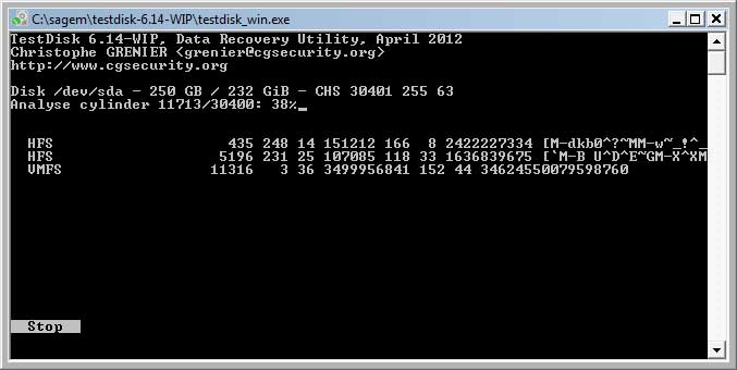

When I select Intel it presents me with the follow message, before I start searching for partitions.
The Intel scan result is as follows.
Intel scan result
Intel scan result
The none scan result is as follows at 38% complete. At 100% there are a few more lines of HFS and VMFS.
None scan result
None scan result
I hope that helps.
Re: SAGEM DTR67250
Posted: 17 Apr 2012, 16:58
The MBR and boot sector have a signatur that they're valid.
If they're not valid, you'll receive this message.
If there is no partition nor boot sector like in your case, you'll get this message too.
It's a screen from Quick Search.
A Screen from Analyse would be appreciated too.
You can distinguish it, there is a note, "current partition structur" and would be an screen earlier.
But I assume, it would be empty?
Re: SAGEM DTR67250
Posted: 17 Apr 2012, 18:19
by daystrom
The page with "current partition structure" is identical to the first image except for the title "current partition structure" and the "Partition sector doesn't have the endmark 0xAA55" message, theres no other information.
I can upload the image but theres no extra info below the headings Partition, Start, End and Size. Sorry.
