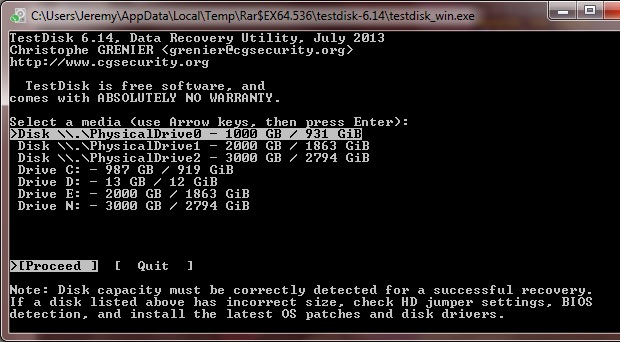

I did 'Create' and then this is the following screen:
^From there I selected the third option which is 'Physical Drive 2 - 3000 GB'

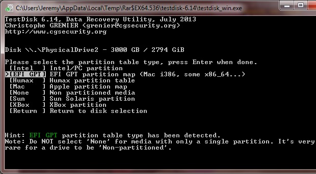

Then on the next screen:
^Here I left it on EFI/GPT and proceeded.

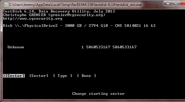

On the next screen I got the options you mentioned in you told me to do in your post earlier 'Run....' which I followed your instructions (Analyse, Quick Search, Stop, A to add partition) and then this is the next screen came up and you said that the starting and ending values need to match the values of the screen shot:
^Now the two values match each other but they don't match the previous screen shot I posted. I just want to make sure I'm doing everything right before I proceed. What should I do next?
