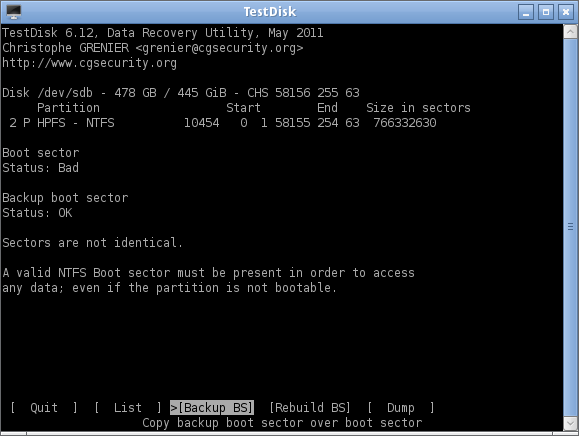

Re: Partition damage following power loss
I followed your instructions and have taken a screenshot. My files are still not listed.
- Screenshot.png (26.86 KiB) Viewed 16988 times
There is also a valid backup from your previous bootsector.
Did you check your files at list from your backup of your bootsector or Rebuild BS?
Or both?
Or both?
