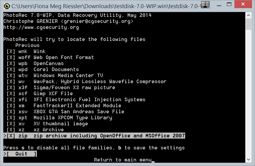

Try to enable zip files only!
You can watch my display here:
If it doesn't work, I'll ask for, what filetype family will be the correct one.

Zip file did it, success. Recovered what I was looking for, thanks!
