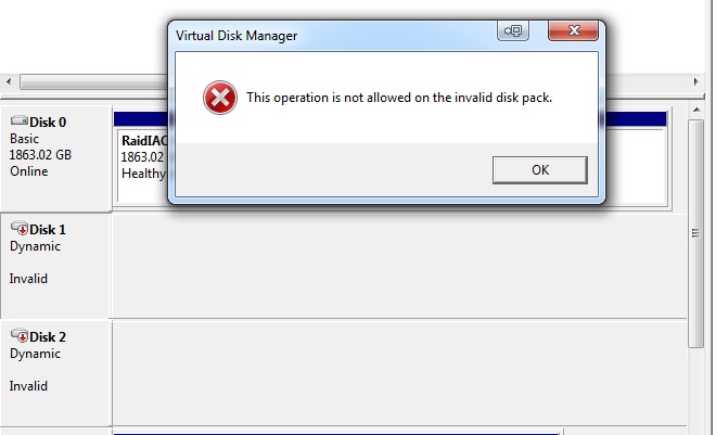

I recently got a new video card from a different manufacturer and... long story short I decided to format and reinstall my Windows 7 Ultimate Install to make things go smoothly. Everything went well, I went through the routine of installing various drivers and programs. Unexpectedly my "Archive" RAID1 array stopped working (where I keep all my important files, thus the mirror). Windows listed both as invalid and I tried to restore them and got an error.

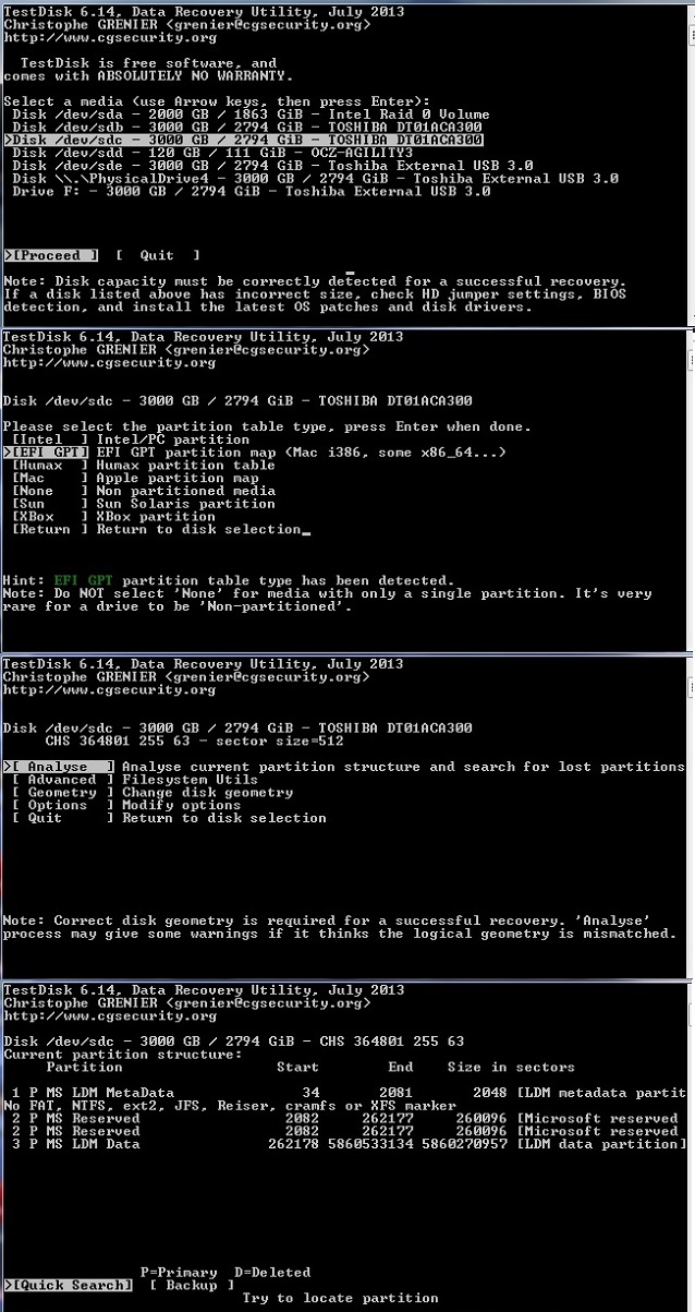

I ran testdisk and it was only detecting the drives as 746GB. I looked in the forum and determined that I needed the Intel drivers to allow the 3TB drives to function (my mistake hopefully not a permanent one).
After installing the drivers testdisk detects them both as 3TB (yay). It seems to be ok detecting the partitions.
First
First
I ran a quick search. 8 hours later I got a series of random partitions (apparently normal?) with only 1 being 3000GB. After picking that one I looked and it showed the correct "name" of the drive (yay). Thinking I had it in the bag I selected that, hit P to view the files expecting to start a file-dump to my handy external backup drive....and only 1 file was detected correctly (from the root directory if I remember correctly).

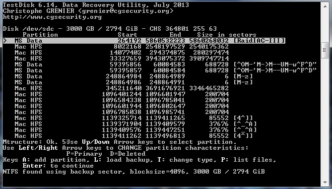

Deep scan had same results. Detects the "named" partition but not all the files.
Named
Named
Only a single file then the same file repeated at 0 size with no directories. I copied the single file succefussly but I'm looking for the others (thousands no doubt). I tried to go to each of the detected partitions to see if any of the junk ones had the files, but somehow got dumped to the main menu after looking at a bad one. I must not understand the menu system for testdisk, is there a menu tree-somewhere?
The log is really long at this point...but when I go to list the files (the point where what I am seeing doesn't match the step-by-step guides) it says:
"ntfs_readdir failed for cluster 5"
