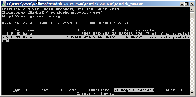

I got testdisk and started working with it - when I open testdisk, select the harddisk, then select EFI/GPT, then Advanced>File System Utilities, I get the following partition layout for the disk, which actually looks correct:
The first partition = looks like the 2.7 tb truecrypt partition
The second = looks like the regular 3gb ntfs partition I created after the truecrypt partition :

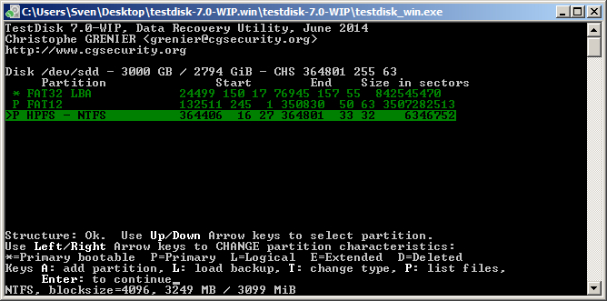

When I run a scan on the disk (using the Intel/Pc partition type) I get the following scan results: the highlighted partition looks correct, it's the size of the one I created. The other 2 above it, I don't know what they are I never created them. The scan did not detect the 2.7 tb encrypted partition because I believe that scan type only detects ntfs/fat partitions:
I figure, I need to at least get the partition layout back to what it was when I encrypted that partition with truecrypt, if I ever want to get it mounted again, whether normally or with an embedded backup header. I'm wondering what next step I should take - is it possible to recover that 3gb partition that testdisk detects? any thoughts are appreciated
