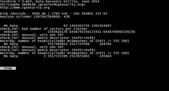

After 3TB WD drive went thru EFI-GPT detection of partition.jpg (40.45 KiB) Viewed 3377 times

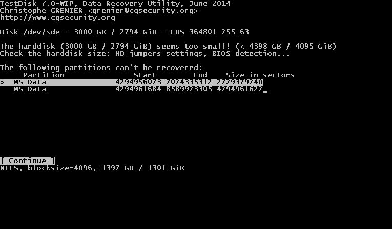

And five hours later, I awoke to this:
Hours after the last screen capture. Bad sectors.jpg (27.74 KiB) Viewed 3427 times
My guess is the drive has three partitions, a small Acronis bridge that allows for XP to see the larger drive, than the two real partitions. I'll be righteous and admit I'm wrong if it's explained. By no means do I think I know everything - in fact I'm struggling just to try to understand this.

So, Christoph?, how hard would it be to build in a 'save' position feature, so after 36+ hours of doing a scan and you press the wrong button, you could resume where you left off instead of having to do the entire thing all over again? Why, you ask?... Maybe it did better than not, but I thought I was at a point where I was willing to gamble writing a partition it had found, "unable to write" it reported and this time, I only had the choice of deeper search or quit and since I didn't think I could keep my system running for the next 56 hours, I hit 'Q' and was back at the analyze screen instead of back at the partiti
