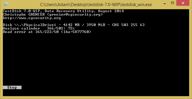

My 3To Seagate was not recognized anymore by explorer, Disk Manager show me it becomes raw file and the partition size is just 3Go now. Strange nah?!
I did a deep analyze with Test Disk, it take 12 hours, there are obviously “Read error”
Screenshot (389).jpg (71.43 KiB) Viewed 11964 times

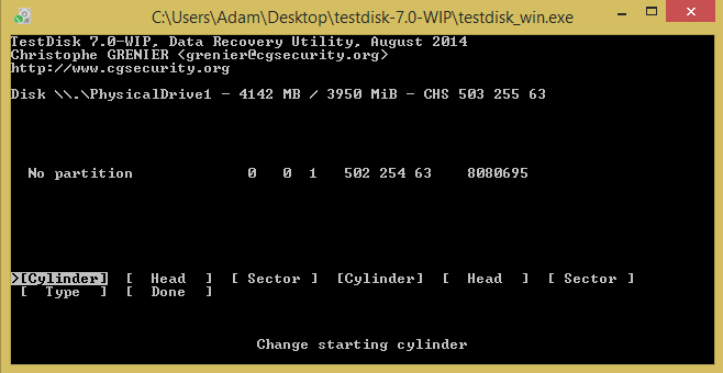

After that I have choose “Add Partition” but now I don’t really know which values write in there, to try to find out my old NTFS partitions?
Screenshot (390).jpg (76.06 KiB) Viewed 11964 times

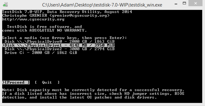

Under disk selection you should select your Disk instead of a Drive.
How is your disk listed?
Can you upload a screen shot from your disk selection?

I selected Disk, i can't see the drive anyway. The highlight disk should be a 3To disk and have 3 partitions. :|
Screenshot (408).jpg (98.41 KiB) Viewed 11958 times

Did you use testdisk 64bit again?
Your disk selection looks like?
Also the size of your selected disk is 4 MB only.
That disk below displays 3 TB.
Would it be possible that the size of your disk is wrong?

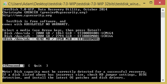

This time I’ve used 32bit version, it tells me exactly the same thing about it. u_u
Screenshot (448).jpg (77.03 KiB) Viewed 11924 times
The disk previously selected looks like this :
Yes Fiona you point out the right issue, size is badly wrong! >.<
The empty 3To disk below is there to host clone or files from the crashed disk. But obviously I can’t access yet :/
Thanks.^^
