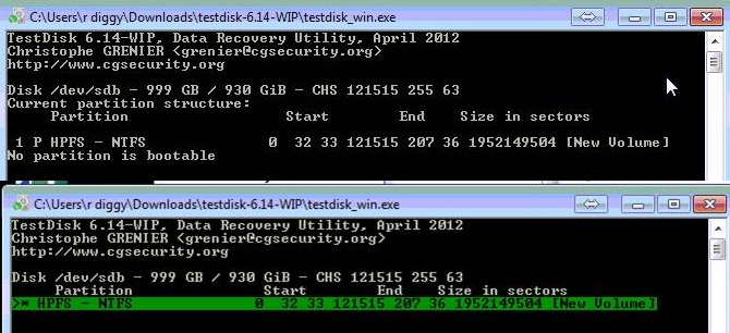

Would it be possible to get some infos from TestDisk Analyse and Quick Search to determine wether a recovery might be possible or not?
Re: accidentally formatted external 1tb drive
I think this is what you wanted?
- analyze.jpg (91.08 KiB) Viewed 38644 times
After a deep scan it still showed the same partition information. Pressing P to list files showed the system info and recycle bin but nothing to recover. What else can be done?
It looks like that the file system is overridden.
