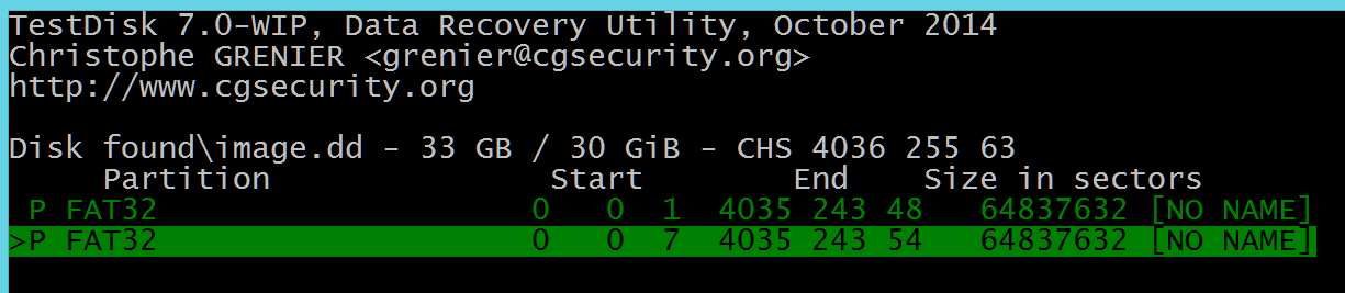

I have been trying to use TestDisk to try and recover the original partition so that I can somehow put the media card back into my z10 device and continue the decryption process (if it actually can continue). I do know the keys should still be on the device and decryption should technically be possible. Although I am not so sure of the latter as I do not know the encryption scheme used.

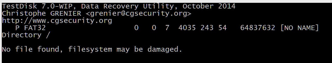

When doing a deep scan analysis I notice that TestDisk will find two partitions (shown below). Unfortunately when I try to list the files on the second partition the message No file found, filesystem may be damaged appears. This is where I am stuck. Is there a way to repair this file system to remove the added directories of the passport and attempt to get the original files listing again? Note: I say original files listing because the device does not encrypt the file system but rather the content of each file. As a result, you can view the directory/file structure but when you open any of the files the content is not 'viewable' as it is encrypted.
Any help would be greatly appreciated. Thanks.
after deep analysis
after deep analysis
trying to list the files in the 7GB partition
