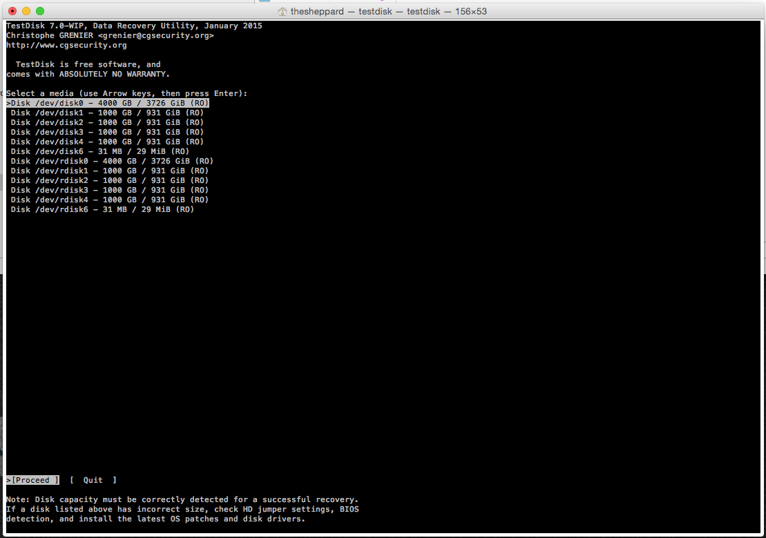

When I open testdisk, the "Create, Append, No Log" menu comes up, I continue using the "Create" function. It leads me to another menu, where I choose Sudo, type in my password, and then it takes me back to the "Create, Append, No Log" menu. I choose "Create" and the attached picture is what I get.
I can't tell which drive is the one I need to choose. Thanks!
