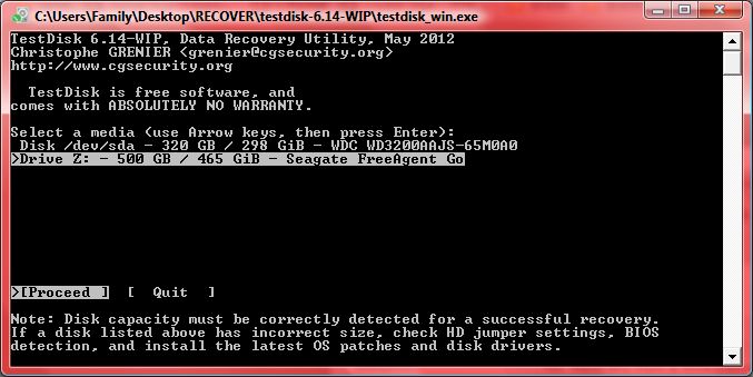

i do not understand the difference between disk and drive. this is what shows when i run testdisk
the one highlighted is the one i wanted to recover files from.
should i proceed?

Re: Recovery from a RAW filesystem
#5 Post by Fiona »
Disk is your physically device!
Drive is a partition how it appears in your explorer.
On this screen;
http://forum.cgsecurity.org/phpBB3/down ... php?id=477
Your Disk is a WDC WD3200aajs-65M0A0
Below you see only your drive which has drive letter Z: .
That's it.
Would it be possible to upload another screenshot from your disk management console.

the disk WDC WD3200aajs-65M0A0 is my internal hard disk. what i want to recover files from is my 500gb external hard disk, but i do not understand why it is listed as drive instead of disk.
hoping you can give more advice, thank you so much
