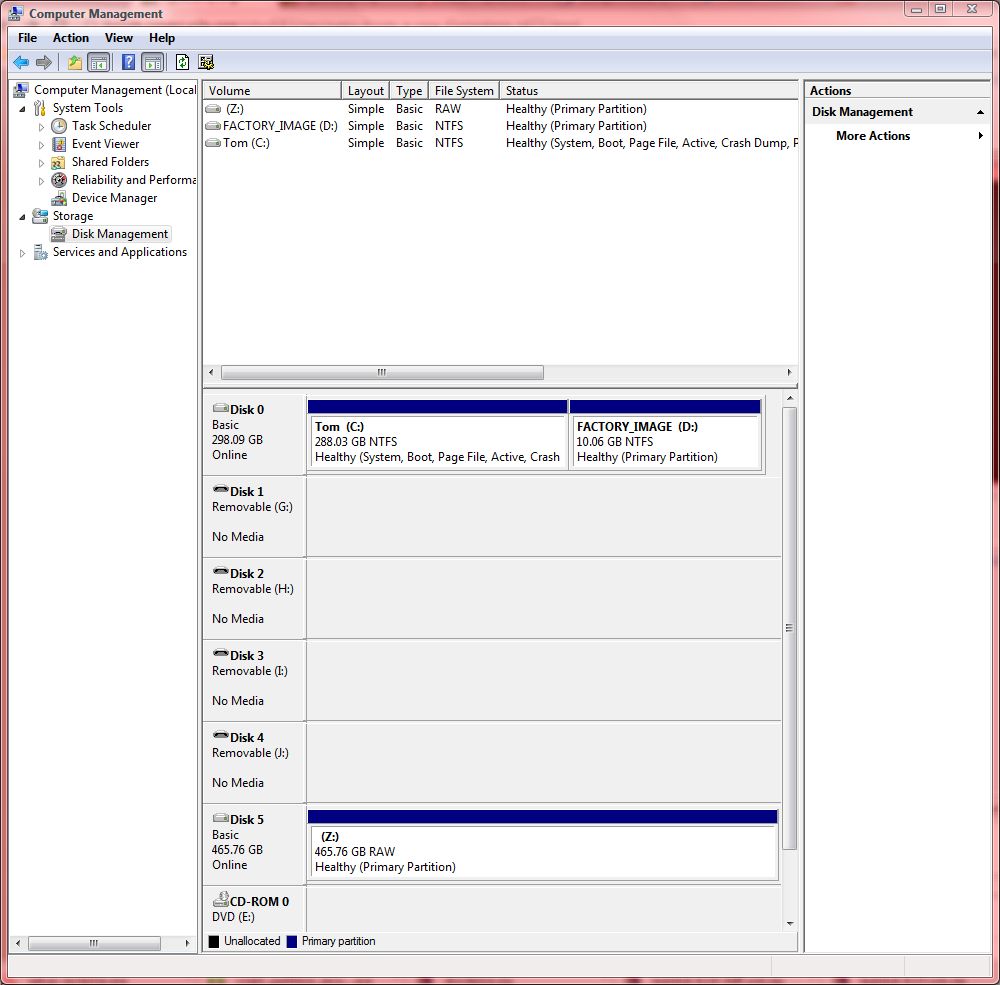

My seagate 500gb external portable harddisk was working yesterday, but when I plugged it in today, it's memory became 0 bytes. I checked disk management and it said the harddisk (which has only 1 partition) has a RAW filesystem, instead of the NTFS i was expecting.

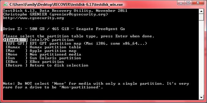

i selected INTEL in the type of partition.

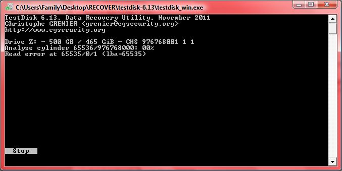

when i analysed, it said READ ERROR
so i did quick search, and this is what happened.
it seems to take so long and is not yet finished. am i doing it right?

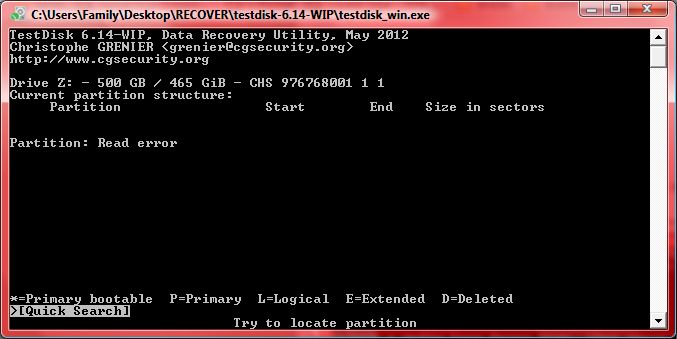

Would it be possible to use the version 6.14WIP?
Did you run TestDisk as administrator?
You should select your disk not the drive?
Please use the 32 bit-version.

i am now using the 6.14 version. and i am also running as administrator and i believe this is also 32 bit.

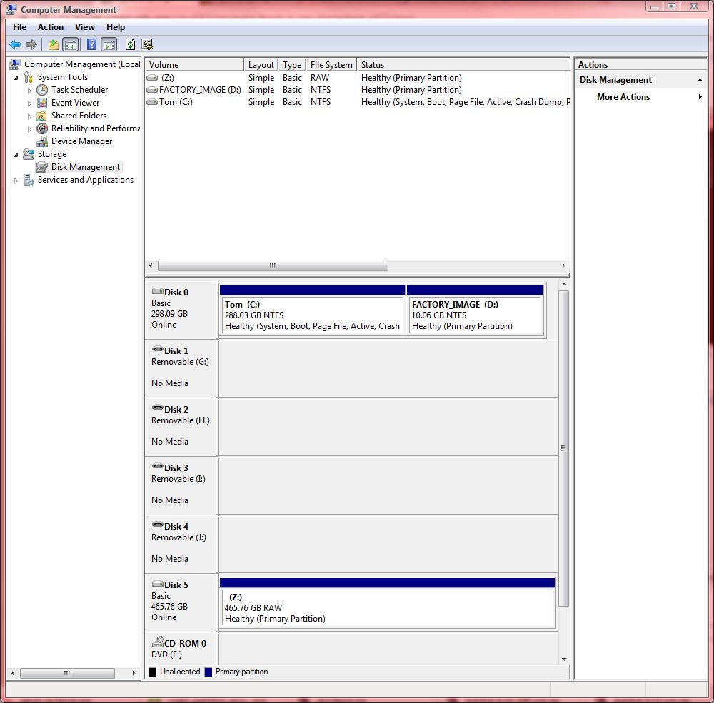

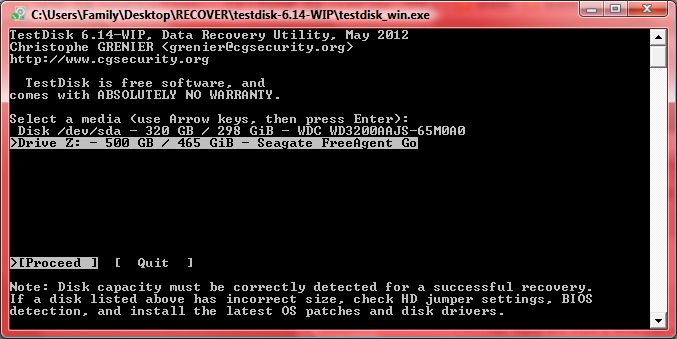

i do not understand the difference between disk and drive. this is what shows when i run testdisk
the one highlighted is the one i wanted to recover files from.
should i proceed?

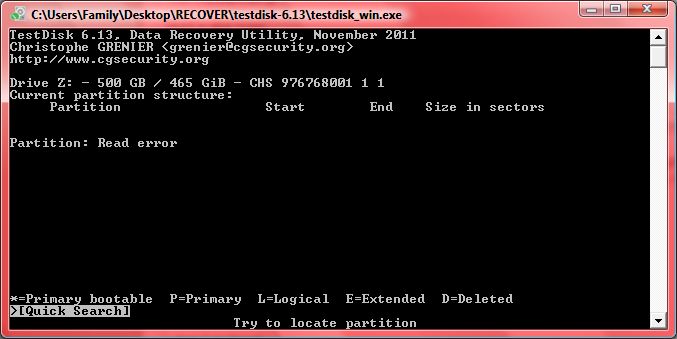

when i proceeded, it was still the same

Disk is your physically device!
Drive is a partition how it appears in your explorer.
On this screen;
http://forum.cgsecurity.org/phpBB3/down ... php?id=477
Your Disk is a WDC WD3200aajs-65M0A0
Below you see only your drive which has drive letter Z: .
That's it.
Would it be possible to upload another screenshot from your disk management console.

the disk WDC WD3200aajs-65M0A0 is my internal hard disk. what i want to recover files from is my 500gb external hard disk, but i do not understand why it is listed as drive instead of disk.
hoping you can give more advice, thank you so much

Posted: 10 May 2012, 12:01
Your HDD is listed correctly.
Except file system is not displayed.
But the cause might be your boot sector or file system.
It could be diagnosed using TestDisk.

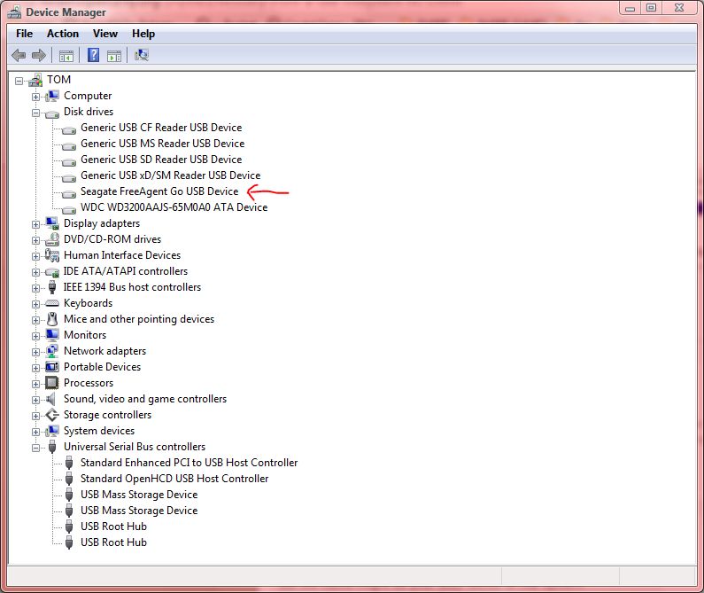

Could you have a look into your device manager how your disk will be listed there?
It should be listed as USB Device and you should see the brand of your disk.
Please check it and let me know.
Re: Recovery from a RAW filesystem
Posted: 10 May 2012, 12:32
by elumenel
Hi, yes the device is listed as follows.
i should say that whenever i plug in this harddisk, it takes a long time for my computer to detect it (it takes a long time in disk management for example), and sometimes my windows explorer crashes.
