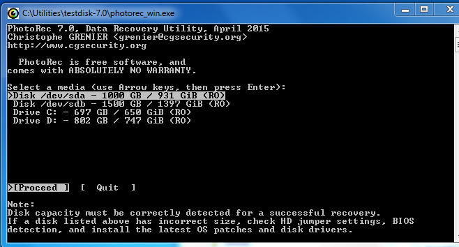

The initial Drive list for my PC.
Photorec Drivers Display.PNG (50.52 KiB) Viewed 4126 times

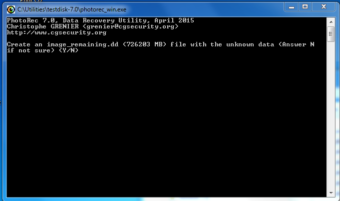

I am attempting to recover a 1TB int drive with many large .iso files using Photorec 7.0 to a int data drive(750GB). The recovery ran for approximately 3hrs at which point I stopped it and created a image_remaining.dd file when I realized that the recup.dirxxxx folders(1098) contained only small(4kb) .mpg files, not large .iso files. Something is not right, can anyone explain why I don't see .iso files on my destination drive? Did I miss a setting? I have attached the initial drive list screen and the last screen which hung for some reason.
:o
Last Scrn shot before it hung.
Photorec_remain Scrn.PNG (58.01 KiB) Viewed 4126 times
