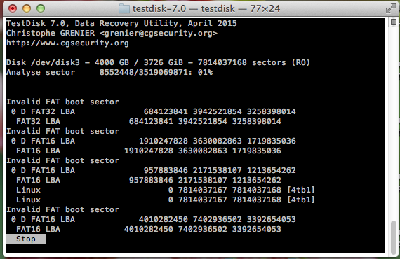

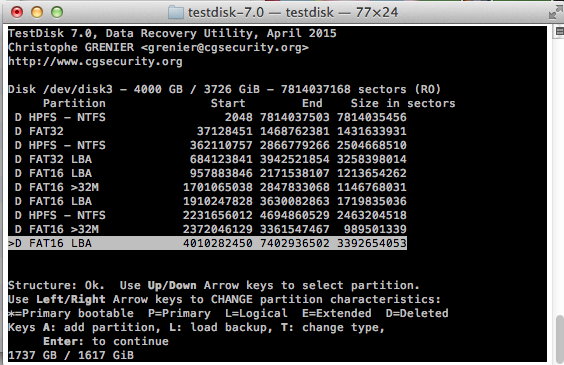

Having installed testdisk on an Intel Mac, running a scan on rdisk
Screen Shot 2015-05-05 at 9.22.40 AM.png (59.02 KiB) Viewed 7151 times
Here are the scan results
Screen Shot 2015-05-05 at 9.11.55 AM.png (49.78 KiB) Viewed 7151 times
on https://join.me/902-051-711 if you would like to see this happening.. Have also uploaded the log for review.
testdisk.log.zip
(1.6 KiB) Downloaded 817 times

Here's the latest scan results :
Screen Shot 2015-05-05 at 9.39.30 AM.png (62.51 KiB) Viewed 7146 times

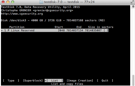

Having stopped this, reviewed the content the content by stepping through; using 'p'. Couldn't see anything legible.
Screen Shot 2015-05-05 at 9.51.28 AM.png (63.8 KiB) Viewed 7143 times
matvrix
Posts: 6
Joined: 04 May 2015, 21:19
Re: Double override
#8 Post by matvrix »
Having to choose 'superblock' doesn't provide any listings..
Screen Shot 2015-05-05 at 11.25.25 AM.png (39 KiB) Viewed 7124 times
