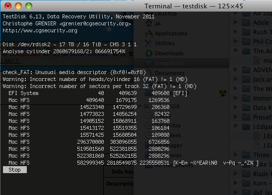

Running "Analyze" follow by EFI GUI FS
Screen shot 2012-03-01 at 11.03.15 PM.png (69.8 KiB) Viewed 22651 times

I then found this link http://superuser.com/questions/152625/d ... 831#367831 and followed this user's tip by choosing INTEL (still don't understand why he chose intel when his system was Mac OS X) and chose "write MBR record". after rebooting still no luck.
Currently I am scanning after chose Analyze followed by "EFI". So far testdisk found 7 or so HFS partition and 1 EFI but there was only one paritition before. I guess Testdisk found actual physical partition instead of 1 logical partition as seeing by Drobo??? Perhaps I should've chosen Apple OS instead of EFI? When I started testdisk it was defaulted to EFI which is why I chose it and running analyze. Can please someone walk me through which FS and run which option? I'd be much appreciated if someone can help me here.

EFI GPT is the correct partition table type. Using TestDisk 6.14-WIP, can you post screenshots of Analyse and Quick Search ?

Thank you so much for your reply :mrgreen: . As you asked me to run 6.14 I killed the previous session as you can see.
