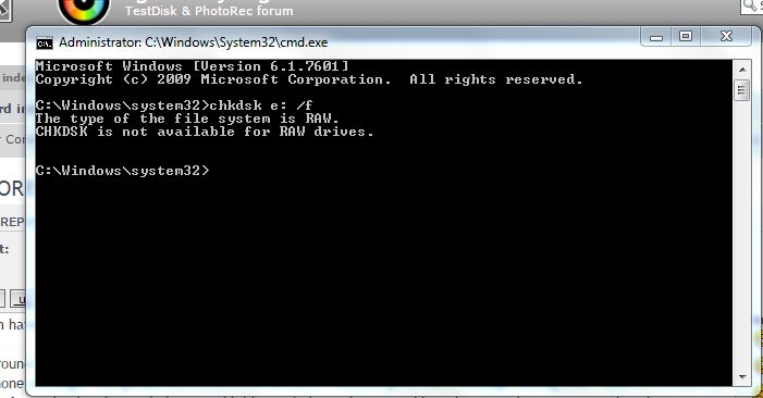

Hi I am having a similar issue. Figured I could post it here instead of a new thread...
Background: Trying to recover files (primarily pictures and music but would like to get everything back if possible) from a 32GB SanDisk microSD which corrupted while in my Samsung Galaxy Note 4. I have not written new files or attempted to format the drive with the intention of attempting a file recovery.
The phone no longer recognizes and mounts the SD card.
Windows gives me a message stating that I need to format my drive before using it.
I have tried to run chkdsk as admin on the SD card but I keep getting a response that "the type of file system is RAW" and chkdsk does not work RAW drives.
Through internet searching I came across a recommendation for your software specifically working when chkdsk gives the RAW message. I have tried utilizing the photorec_win but I am noticing that when selecting the drive it is listed as being 32MB when the card is in fact 32GB.
The message displayed at the bottom of the program states it should not show up that way.
I have gone through the process of trying to recover files but with no results. It searches twice for about 2 seconds each and I get a response that there are no files found.
Do you have any recommendations of what to try?
