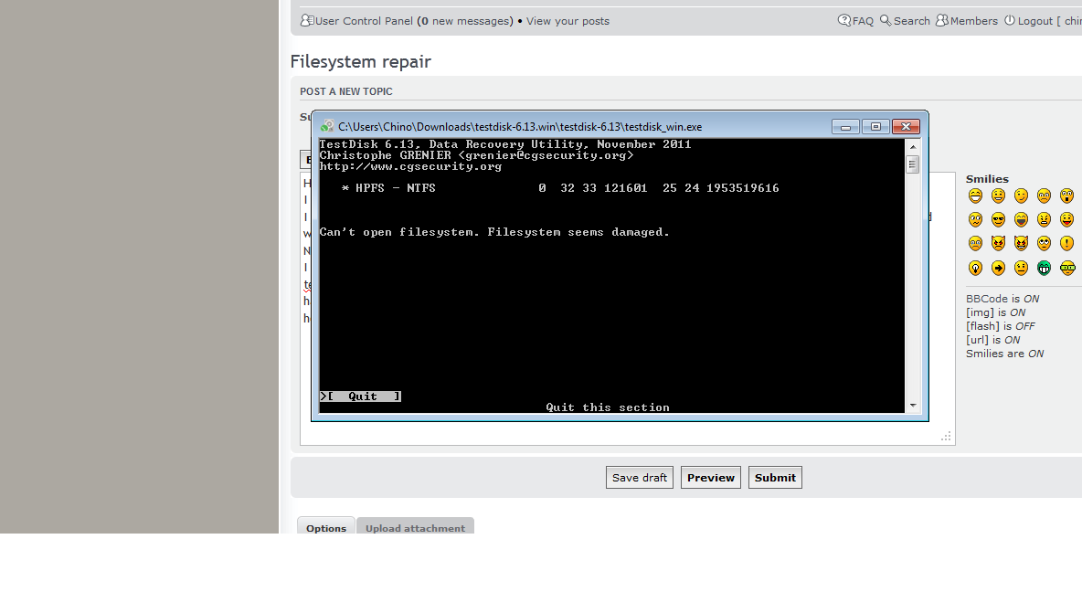

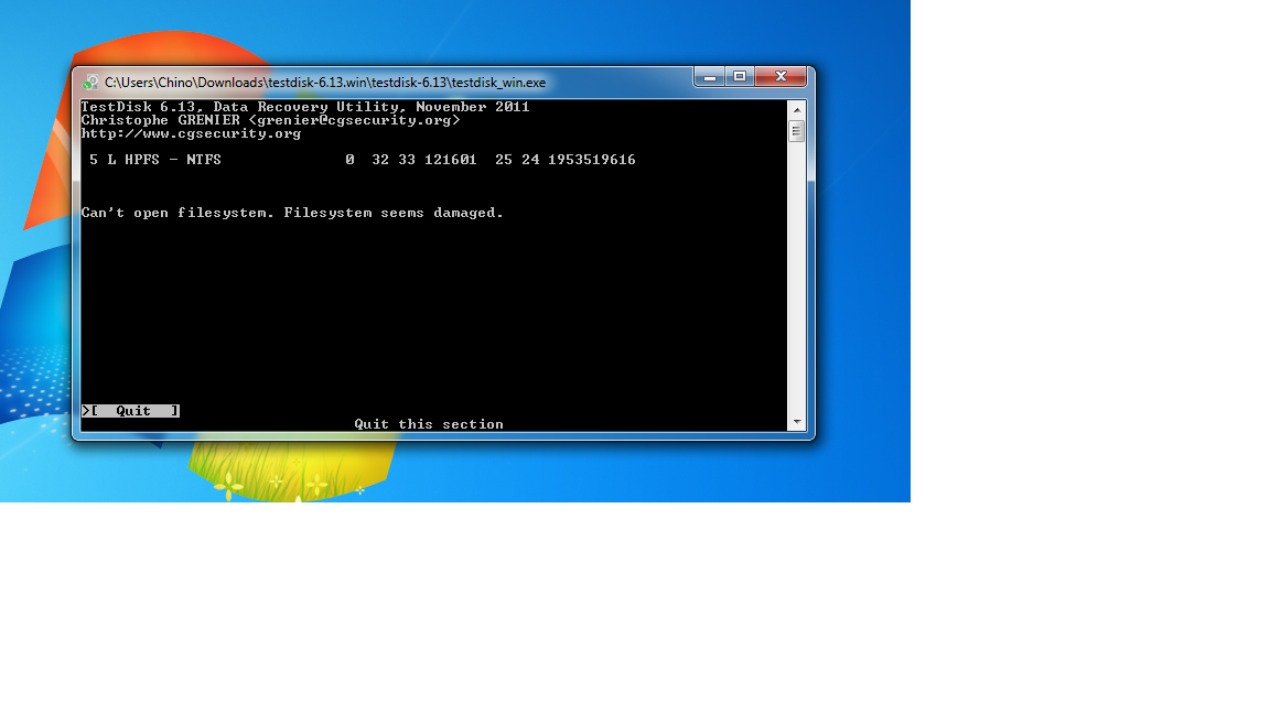

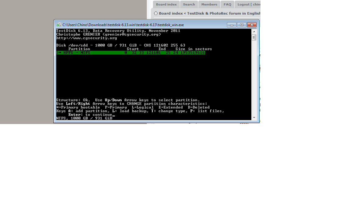

testdisk says structure is ok, but the system files are damaged. I know the Drive is good. the particular drive that i have issues with is not that old nor used as much.
here are some images just in case. I am a real noob with Hard drives, first time this has ever happened....

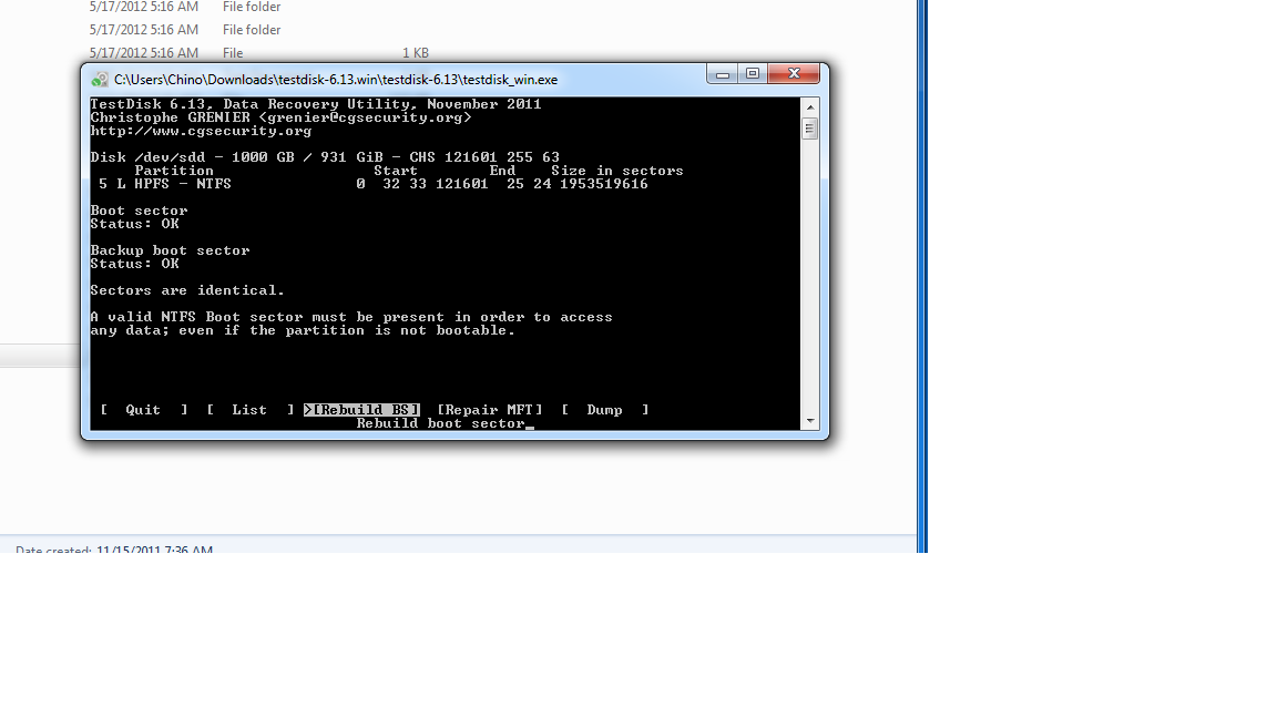

To run chkdsk, windows must recognize your boot sector correctly to acces a damaged file system.
If a file system is seriously damaged then it might be possible that windows doesn't recognize it either.
You should have a boot sector diagnose first.
Confirm at Boot.
Please let us know, do you see your data or an error message.

I really appreciate your help with my issue. I ran the boot, Rebuild BS. Unfortunately, the Rebuild BS did go through.

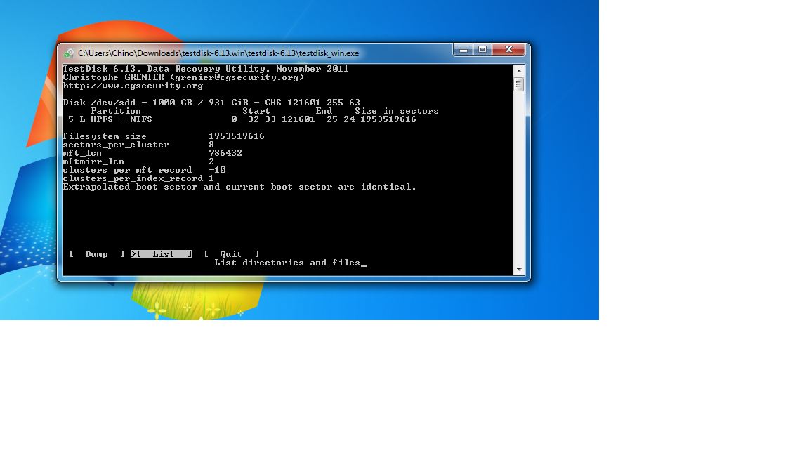

I also hit the repair MFT and i got a weird message. heres the pics

The repair MFT Pic
