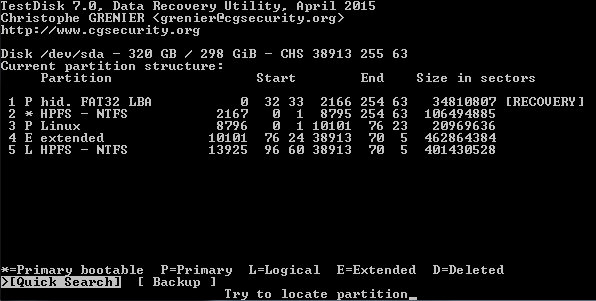

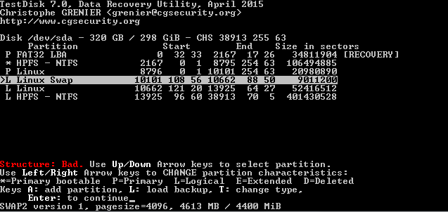

To make long story short - I recovered Win7 from the hidden partition on a dual boot laptop (Win + Linux). As a result, my dedicated /home and swap partitions (that belonged to the extended partition) are now seen by the OS as one free space (figure 1 from the testdisk showing current partition). Using testdisk (under Windows 7) I easily find the both, can access files, but somehow I get an error if I try to remap the disk and recover the lost partitions (figure 2). Does anyone know what the problem might be? I really appreciate any input.

- Current partition table - 3 primary + 1 extended with only 1 logical NTFS inside. There used to be 3 logical partitions, but swap and /home are seen as free space now.

- Is there a problem of overlapping recovery and system NTFS partitions?

Sorry, I've just noticed that the sizes (more exactly, the coordinates of the ends) of recovery FAT32 partitions on the first screenshot and the second are different. My understanding was that the list after quick search should include the both existing and lost/deleted partitions and therefore, the only FAT32 (which had never been touched) should be the same everywhere. Why do the results before and after quick search differ for this partition?
The same applies to the first Linux partition, which limits are different before and after doing quick search...
