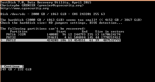

I have just completed the 'deeper search' with the final screen displaying invalid FAT* partitions:
Final screen of the deeper search
Here is the contents of the .log
Wed Jul 22 11:38:00 2015
OS: Windows 8 (9200)
disk_get_size_win32 IOCTL_DISK_GET_LENGTH_INFO(\\.\C:)=999835041792
disk_get_size_win32 IOCTL_DISK_GET_LENGTH_INFO(\\.\D:)=2000396746752
disk_get_size_win32 IOCTL_DISK_GET_LENGTH_INFO(\\.\E:)=121432064
Disk /dev/sdb - 2000 GB / 1863 GiB - CHS 243201 255 63, sector size=512
Disk /dev/sdc - 2000 GB / 1863 GiB - CHS 243201 255 63, sector size=512
Drive C: - 999 GB / 931 GiB - CHS 121556 255 63, sector size=512
Drive D: - 2000 GB / 1863 GiB - CHS 243201 255 63, sector size=512
Drive E: - 121 MB / 115 MiB - CHS 28 64 32, sector size=2048
NTFS at 0/32/33
 1 P HPFS - NTFS              0  32 33 243201  45 44 3907024896
NTFS at 0/32/33
filesystem size           3907024896
sectors_per_cluster       8
mftmirr_lcn               2
clusters_per_mft_record   -10
file_pread(6,2,buffer,3907031040(243201/110/46)) lseek err Invalid argument
file_pread(6,1,buffer,3907031040(243201/110/46)) lseek err Invalid argument
file_pread(6,8,buffer,3907029248(243201/82/18)) lseek err Invalid argument
file_pread(6,8,buffer,3907029376(243201/84/20)) lseek err Invalid argument
file_pread(6,8,buffer,3907029504(243201/86/22)) lseek err Invalid argument
file_pread(6,8,buffer,3907029632(243201/88/24)) lseek err Invalid argument
file_pread(6,8,buffer,3907029760(243201/90/26)) lseek err Invalid argument
file_pread(6,8,buffer,3907029888(243201/92/28)) lseek err Invalid argument
file_pread(6,8,buffer,3907030016(243201/94/30)) lseek err Invalid argument
file_pread(6,8,buffer,3907030144(243201/96/32)) lseek err Invalid argument
file_pread(6,8,buffer,3907030272(243201/98/34)) lseek err Invalid argument
file_pread(6,8,buffer,3907030400(243201/100/36)) lseek err Invalid argument
file_pread(6,8,buffer,3907030528(243201/102/38)) lseek err Invalid argument
file_pread(6,8,buffer,3907030656(243201/104/40)) lseek err Invalid argument
file_pread(6,8,buffer,3907030784(243201/106/42)) lseek err Invalid argument
file_pread(6,8,buffer,3907030912(243201/108/44)) lseek err Invalid argument
file_pread(6,1,buffer,3907031039(243201/110/45)) lseek err Invalid argument
file_pread(6,14,buffer,3907031041(243201/110/47)) lseek err Invalid argument
file_pread(6,3,buffer,3907031055(243201/110/61)) lseek err Invalid argument
file_pread(6,3,buffer,3907031102(243201/111/45)) lseek err Invalid argument
file_pread(6,8,buffer,3907031118(243201/111/61)) lseek err Invalid argument
file_pread(6,11,buffer,3907031165(243201/112/45)) lseek err Invalid argument
file_pread(6,2,buffer,3907033087(243201/143/14)) lseek err Invalid argument
   * HPFS - NTFS              0  32 33 243201  45 44 3907024896
NTFS at 0/32/33
mftmirr_lcn               2
BAD_RS LBA=2261990189 4565655
     FAT16 >32M           140802  96 12 244793 235 13 1670624174
This partition ends after the disk limits. (start=2261990189, size=1670624174, end=3932614362, disk end=3907029168)
The harddisk (2000 GB / 1863 GiB) seems too small! (< 2013 GB / 1875 GiB)
NTFS at 0/32/33
NTFS at 0/32/33
mftmirr_lcn               2
Thanks again. Tim

Re: *HELP* Whole NTFS disk/partition recovery?
#6 Post by Fiona »
Did you complete Deeper Search?
Regarding this message:
If Deeper Search doesn't help, you can try PhotoRec.
Info:
You can use the menu FileOpt and press s to deselect all file types and only mark those file types, where you'd like to recover.
