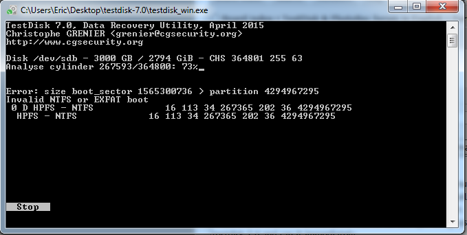

1.PNG is the first screen. I then selected [Intel]->[Analyse]. 2.PNG showed up and I have no idea what's going on.
The search isn't completed but when I hit stop it will give me
one line highlight in green, (3 attachment max so I cannot attach any more pic)

when the quick search is completed, took hours to finish. I have the following:
quick search complete.PNG (47.61 KiB) Viewed 10591 times

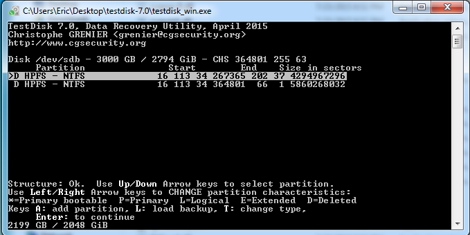

and then I have
6 - 2 partition.PNG (55.71 KiB) Viewed 10591 times
and
6 - 2 partitionb.PNG (55.48 KiB) Viewed 10591 times
the default is to delete both partition? cuz it has a d beside it. However, wouldn't I end up with nothing if both is deleted? if I put L for both it will say bad . Any help is appreciated.

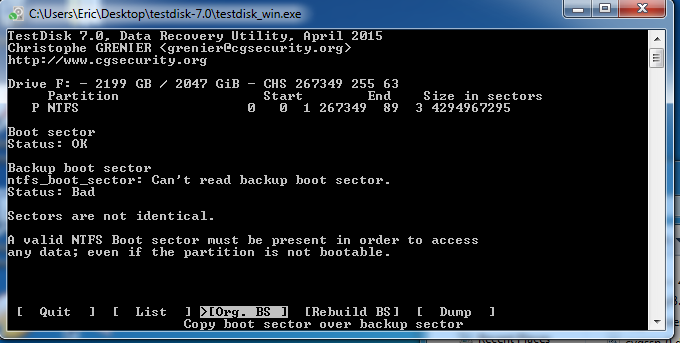

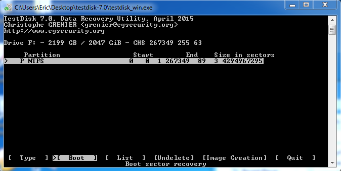

How about if I select the drive instead of the disk as follow:
and for partition table type, the default is [None], so I didnt choose [Intel]
[Advanced]-> [Boot]
The below shows the sectors are not identical
Should I choose [Org. BS] at this point? Thanks.

now under storage in windows:
Disk 1 is the drive in question.
The 746.39gb looks like didn't get append or recognize together with the 2tb. And there was only one partition before, not two.
Can anyone please help?
No, a bad backup of the boot sector often indicates some problems with the file system too.
Also I'm not sure did you run a boot sector diagnose on your right partition.
In your current partition table the partition ends at cylinder 267365.
It's exactly the Intel MBR limit at 2.2 TB.
You can watch it here, at the bottom of your display:
http://forum.cgsecurity.org/phpBB3/down ... hp?id=3239
That's why I don't recommend to modify your file system running OrgBS.
Intel MBR supports only disks and partition up to 2.2 TB.
The second partition on this testdisk display uses almost the whole space till the end of your disk.
Did you select this partition and did you press p to have a try to list your files?
The size of the first partition is much smaller, maybe around 2 TB and overlaps your second partition.
That's why it would only be possible to recover 1 partition.

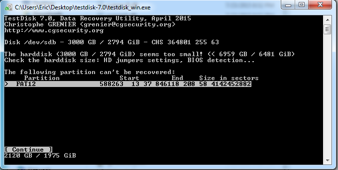

Can you copy and paste the content of your testdisk.log into your next post?
You'll find it within your testdisk folder.

BAD_RS LBA=860511358 6744153
file_pread(5,3,buffer,860511358(588263/13/37)) lseek err Invalid argument
file_pread(5,1,buffer,860511358(588263/13/37)) lseek err Invalid argument
FAT12 588263 13 37 846118 208 58 4142452882
This partition ends after the disk limits. (start=9450445950, size=4142452882, end=13592898831, disk end=5860533168)

The harddisk (3000 GB / 2794 GiB) seems too small! (< 6959 GB / 6481 GiB)
* HPFS - NTFS 16 113 34 267365 202 37 4294967296
NTFS, blocksize=4096, 2199 GB / 2048 GiB
1 * HPFS - NTFS 16 113 34 267365 202 37 4294967296
NTFS at 16/113/34
filesystem size 4294967295
mftmirr_lcn 2
HPFS - NTFS 16 113 34 267365 202 36 4294967295
NTFS, blocksize=4096, 2199 GB / 2047 GiB
HPFS - NTFS 16 113 34 364801 66 1 5860268032
NTFS found using backup sector, blocksize=4096, 3000 GB / 2794 GiB

dir_partition inode=5
